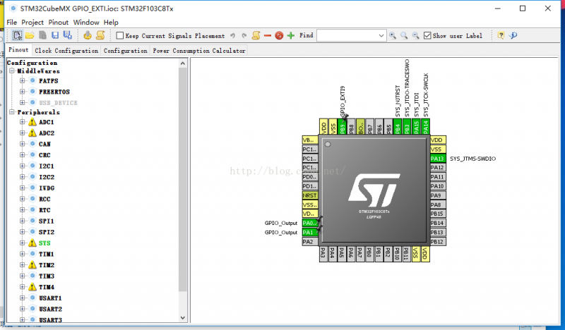

芯片:STM32F103C8T6
应用管脚:
输出:PA0、PA1
输入:PB9
配置界面
NVIC增加中断
程序中增加回调函数
/* USER CODE BEGIN 4 */
  * @brief  EXTI line detection callback
  * @param GPIO_Pin: Specifies the pins connected EXTI line
  * @retval None
void HAL_GPIO_EXTI_Callback(uint16_t GPIO_Pin)
if(GPIO_Pin == GPIO_PIN_9)
HAL_GPIO_WritePin(GPIOA,GPIO_PIN_1,(GPIO_PinState)!HAL_GPIO_ReadPin(GPIOA,GPIO_PIN_1));
/* USER CODE END 4 */
