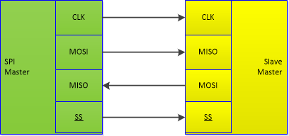

本节列出了所有端口的名称和描述,包括可以或可能在芯片外连接的输入和输出。 SPI模块共有4个外部引脚。
2.2 信号详细说明
2.2.1 MOSI
该引脚用于在SPI模块配置为主器件时将数据传输出SPI模块,并在配置为从器件时接收数据。
2.2.2 MISO
该引脚用于在SPI模块配置为从器件时将数据传输出SPI模块,并在配置为主器件时接收数据.
2.2.3 SS
该引脚用于将选择信号从SPI模块输出到另一个外设,当配置为主机时,将其作为数据传输进行,当SPI配置为从机时,它用作接收从机选择信号的输入。
2.2.4 SCK
该引脚用于输出SPI传输数据或接收时钟的时钟。

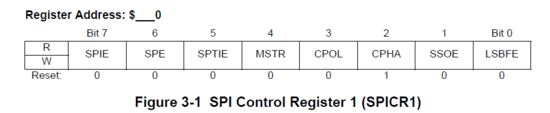

3.1.1 SPI Control Register 1
 SPIE — SPI Interrupt Enable Bit
This bit enables SPI interrupt requests, if SPIF or MODF status flag is set.
1 = SPI 中断使能.
0 = SPI 中断失能.
SPE — SPI System Enable Bit
该位使能SPI系统,并将SPI端口引脚专用于SPI系统功能。 如果SPE清零,SPI被禁止并强制进入空闲状态,SPISR寄存器中的状态位将被复位。
1 = SPI enabled, port pins are dedicated to SPI functions.
0 = SPI disabled (lower power consumption).
SPTIE — SPI Transmit Interrupt Enable
This bit enables SPI interrupt requests, if SPTEF flag is set.
1 = SPTEF interrupt enabled.
0 = SPTEF interrupt disabled.
MSTR — SPI Master/Slave Mode Select Bit(模式选择)
This bit selects, if the SPI operates in master or slave mode. Switching the SPI from master to slave or vice versa forces the SPI system into idle state.
1 = SPI is in Master mode
0 = SPI is in Slave mode
CPOL — SPI Clock Polarity Bit(时钟极性选择)
This bit selects an inverted or non-inverted SPI clock. To transmit data between SPI modules, the SPI modules must have identical CPOL values. In master mode, a change of this bit will abort a transmission in progress and force the SPI system into idle state.
1 = Active-low clocks selected. In idle state SCK is high.
0 = Active-high clocks selected. In idle state SCK is low.
CPHA — SPI Clock Phase Bit(时钟相位选择)
This bit is used to select the SPI clock format. In master mode, a change of this bit will abort a transmission in progress and force the SPI system into idle state.
1 = Sampling of data occurs at even edges (2,4,6,...,16) of the SCK clock
0 = Sampling of data occurs at odd edges (1,3,5,...,15) of the SCK clock

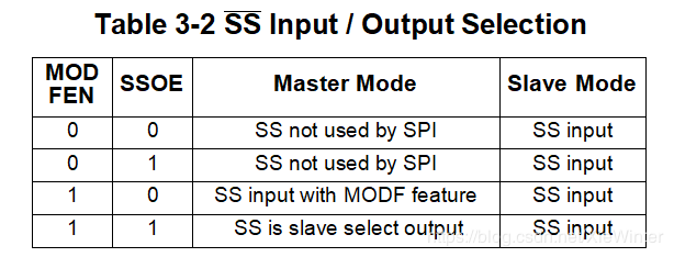

SSOE — Slave Select Output Enable
The SS output feature is enabled only in master mode, if MODFEN is set, by asserting the SSOE as shown in Table 3-2. In master mode, a change of this bit will abort a transmission in progress and force the SPI system into idle state.
LSBFE — LSB-First Enable
该位不影响数据寄存器中MSB和LSB的位置。 数据寄存器的读取和写入始终在第7位具有MSB。在主模式下,更改此位将中止正在进行的传输并强制SPI系统进入空闲状态。
1 = Data is transferred least significant bit first.
0 = Data is transferred most significant bit first.

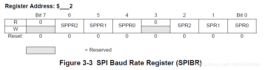

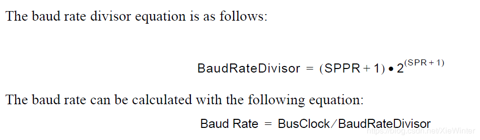

 3.1.3 SPI Baud Rate Register
SPPR2–SPPR0 — SPI Baud Rate Preselection Bits
SPR2–SPR0 — SPI Baud Rate Selection Bits
详细波特率配置对照表见手册

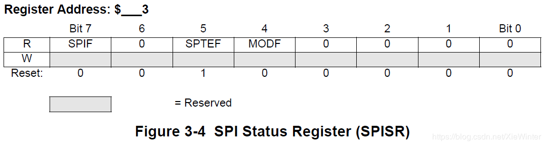

 3.1.4 SPI Status Register
SPIF — SPIF Interrupt Flag
接收到的数据字节传输到SPI数据寄存器后,该位置1。 通过读SPISR寄存器(SPIF置1),然后对SPI数据寄存器进行读访问,可以清除该位。
1 = New data copied to SPIDR
0 = Transfer not yet complete
 SPTEF — SPI Transmit Empty Interrupt Flag
如果置位,该位指示发送数据寄存器为空。 要清除该位并将数据放入发送数据寄存器,必须使用SPTEF = 1读取SPISR,然后写入SPIDR。 在不读取SPTEF = 1的情况下对SPI数据寄存器进行任何写操作都会被忽略。
1 = SPI Data register empty
0 = SPI Data register not empty
MODF — Mode Fault Flag
This bit is set if the SS input becomes low while the SPI is configured as a master and mode fault detection is enabled, MODFEN bit of SPICR2 register is set. Refer to MODFEN bit description inSPI Control Register 2. The flag is cleared automatically by a read of the SPI Status Register(with MODF set) followed by a write to the SPI Control Register 1.
1 = Mode fault has occurred.
0 = Mode fault has not occurred.

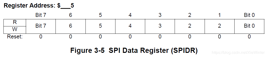

3.1.5 SPI Data Register

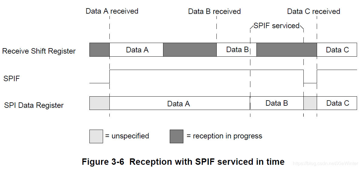

SPI数据寄存器是SPI数据的输入和输出寄存器。 写入该寄存器允许对数据字节进行排队和传输。 对于配置为主设备的SPI,在前一次传输完成后立即发送排队的数据字节。 SPISR寄存器中的SPI发送器空标志SPTEF指示SPI数据寄存器何时准备接受新数据。
当设置SPIF时,SPIDR中的接收数据有效。
如果SPIF清零并且接收到一个字节,则接收的字节从接收移位寄存器传送到SPIDR,并且SPIF置1.
如果SPIF置1且未被服务,并且已接收到第二个字节,则第二个接收字节将作为有效字节保留在接收移位寄存器中,直到另一个传输开始。 SPIDR中的字节不会更改。
如果SPIF置1且有效字节在接收移位寄存器中,并且SPIF在第三次发送开始之前被服务,则接收移位寄存器中的字节被传送到SPIDR并且SPIF保持置1(见图3-6)。
如果SPIF置1且接收移位寄存器中有效字节,并且在第三次发送开始后SPIF服务,则接收移位寄存器中的字节无效并且不会传输到SPIDR中(see Figure 3-7 Reception with SPIF serviced too late)

 通过设置SPI控制寄存器1中的SPI使能位(SPE)来使能SPI系统。当SPE位置1时,四个相关的SPI端口引脚专用于SPI功能:
• Slave select (SS)
• Serial clock (SCK)
• Master out/slave in (MOSI)
• Master in/slave out (MISO)
 SPI系统的主要元件是SPI数据寄存器。 主器件中的8位数据寄存器和从器件中的8位数据寄存器由MOSI和MISO引脚相连,形成分布式16位寄存器。 当执行数据传输操作时,该16位寄存器通过S时钟从主机串行移位8位,因此在主机和从机之间交换数据。 写入主SPI数据寄存器的数据成为从机的输出数据,传输操作后从主SPI数据寄存器读取的数据是来自从机的输入数据。

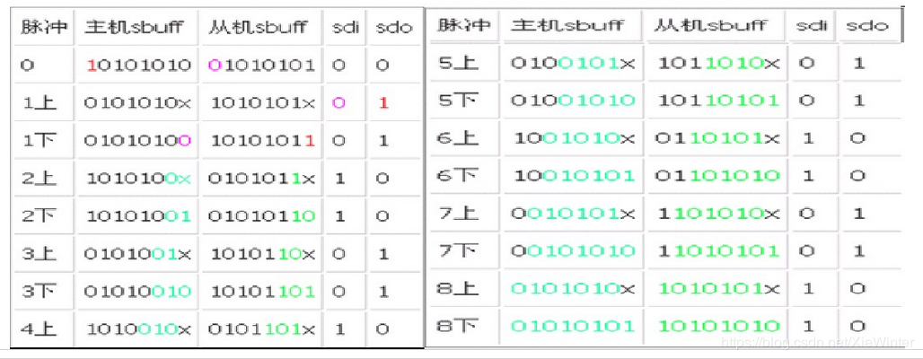

4.2 传输格式
在SPI传输期间,数据被同时传输(串行移出)和接收(串行移位)。 串行时钟(SCK)同步两条串行数据线上信息的移位和采样。 从选择线允许选择单个从SPI设备,未选择的从设备不会干扰SPI总线活动。 可选地,在主SPI设备上,从选择线可用于指示多主总线争用。
 4.2.1 时钟相位和极性控制
使用SPI控制寄存器1中的两位,软件选择串行时钟相位和极性的四种组合之一。
CPOL时钟极性控制位指定有效的高或低时钟,并且对传输格式没有显着影响。
CPHA时钟相位控制位选择两种根本不同的传输格式之一。 主SPI设备和通信从设备的时钟相位和极性应相同。 在一些情况下,在传输之间改变相位和极性以允许主设备与具有不同要求的外围从设备通信。

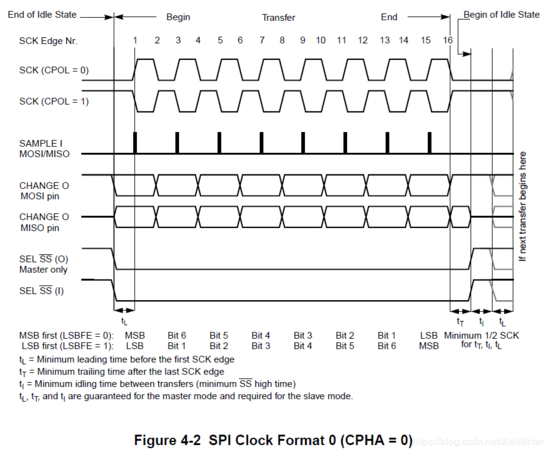

4.2.2 CPHA = 0 传输格式
SCK线上的第一个边沿用于将从器件的第一个数据位计时到主器件,将主器件的第一个数据位计时到从器件。 在某些外设中,只要选择了从机,就会在从机的数据输出引脚上提供从机数据的第一位。 在这种格式中,第一个SCK边沿在SS变低之后发出半个周期。
半个SCK周期后,第二个边沿出现在SCK线上。 发生第二个沿时,先前从串行数据输入引脚锁存的值将移入移位寄存器的LSB或MSB,具体取决于LSBFE位。
在第二个沿之后,SPI主数据的下一位从主机的串行数据输出引脚传输到从机的串行输入引脚。 该过程在SCK线上总共持续16个边缘,数据被锁存在奇数边缘上并在偶数边缘上移位。
数据接收是双缓冲的。 传输期间数据串行移入SPI移位寄存器,并在最后一位移入后传输到并行SPI数据寄存器。
在第16个(最后一个)SCK边缘之后:
先前在主SPI数据寄存器中的数据现在应该在从数据寄存器中,从数据寄存器中的数据应该在主数据寄存器中。
SPI状态寄存器中的SPIF标志置位,表示传输已完成。

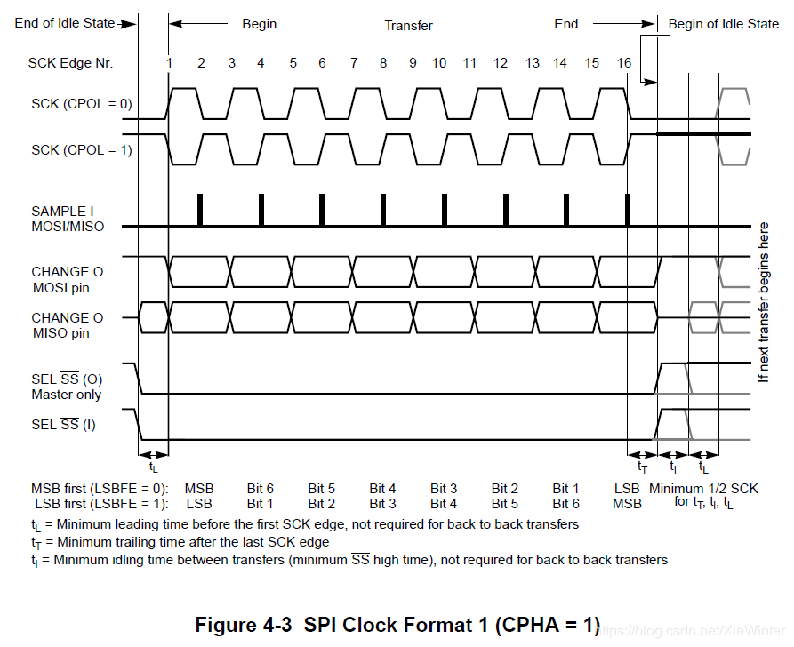

4.2.3 CPHA = 1 传输格式
类似CPHA=0

4.3.1 SS 输出
SS输出功能在传输过程中自动将SS引脚驱动为低电平,以选择外部设备并在空闲期间将其驱动为高电平以取消选择外部设备。 选择SS输出时,SS输出引脚连接到外部器件的SS输入引脚。
通过置位SSOE和MODFEN位,SS输出仅在主模式下在正常SPI操作期间可用,如表3-2所示。
启用SS输出时,模式故障功能被禁用。

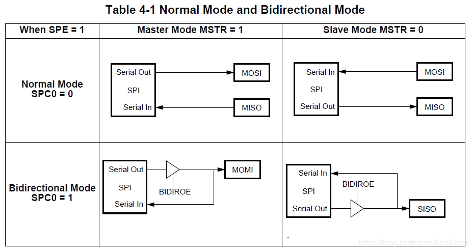

4.3.2 双向模式(MOMI或SISO)
当SPI控制寄存器2中的SPC0位置1时,选择双向模式(见表4-1正常模式和双向模式)。 在此模式下,SPI仅使用一个串行数据引脚作为与外部器件的接口。 MSTR位决定使用哪个引脚。 MOSI引脚成为主模式的串行数据I / O(MOMI,Master Output, Master Input)引脚,MISO引脚成为从模式的串行数据I / O(SISO)引脚。 SPI不使用主模式下的MISO引脚和从模式下的MOSI引脚。
每个串行I / O引脚的方向取决于BIDIROE位。 如果引脚配置为输出,则移位寄存器的串行数据在引脚上被驱动。 相同的引脚也是移位寄存器的串行输入。
SCK输出为主模式,输入为从模式。
SS是主模式的输入或输出,它始终是从模式的输入。 双向模式不影响SCK和SS功能。
