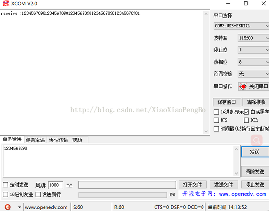

例1:USART1 RX Polling实现
代码:
void USART1_RX_Polling()
int index = 0;
while(1)
if((USART1->SR & USART_SR_RXNE) != 0)
if(index > 50)
break;
buffer[index++] = USART1->DR;
printf("receive :%s",buffer);
运行效果图,直到收到index >50,会整个打印出来

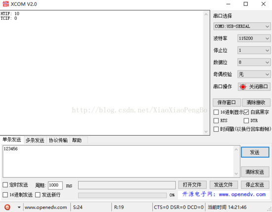

例3:USART1 RX DMA中断的实现
程序源码:
void DMA1_Channel5_IRQHandler(void)
TIM2->EGR = TIM_EGR_UG;
TIM2->SR &= ~TIM_SR_UIF;
NVIC_ClearPendingIRQ(TIM2_IRQn);
if (DMA1->ISR & DMA_ISR_HTIF5)
DMA1->IFCR = DMA_IFCR_CHTIF5;
printf("HTIF: %dn", DMA1_Channel5->CNDTR);
if (DMA1->ISR & DMA_ISR_TCIF5)
DMA1->IFCR = DMA_IFCR_CTCIF5;
printf("TCIF: %dn", DMA1_Channel5->CNDTR);
void USART1_RX_DMA_IRPT()
NVIC_SetPriorityGrouping(4);
NVIC_SetPriority(DMA1_Channel5_IRQn, 1);
RCC->AHBENR |= RCC_AHBENR_DMA1EN;
USART1->CR3 |= USART_CR3_DMAR;
/* 6. CONFIG DMA */
DMA1_Channel5->CMAR = (uint32_t)buffer;
DMA1_Channel5->CPAR = (uint32_t)&USART1->DR;
DMA1_Channel5->CNDTR = 20;
DMA1_Channel5->CCR |= DMA_CCR5_PL | DMA_CCR5_MINC | DMA_CCR5_EN | DMA_CCR5_HTIE | DMA_CCR5_TCIE;
NVIC_EnableIRQ(DMA1_Channel5_IRQn);
while(1);
运行图,从串口发送数据,不光发送多少个,发送10个时候,会触发发送一半中断,发送到20个的时候,会触发发送完成中断
