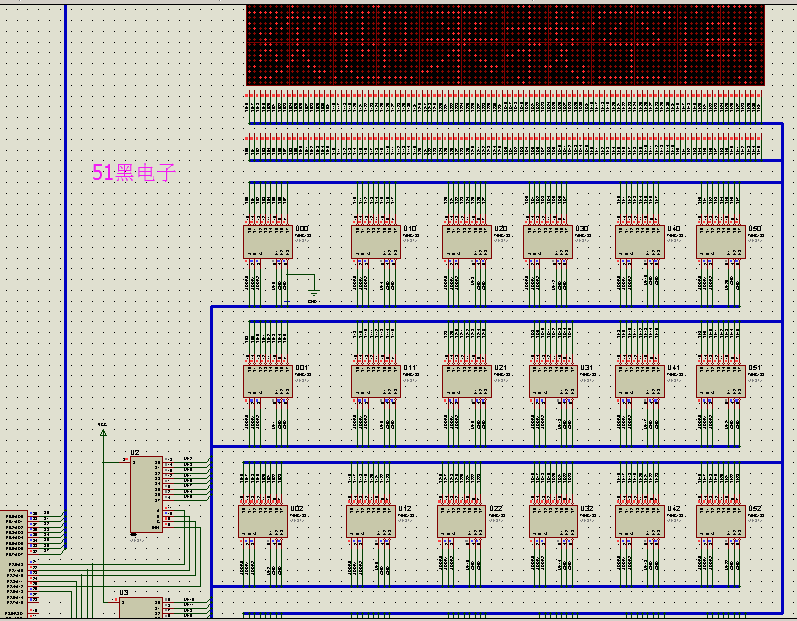

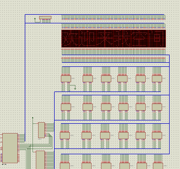

2019年10月15日 | 51单片机+74HC138驱动16*96点阵显示汉字的Proteus仿真+源代码
2019-10-15 来源:eefocus
16*96点阵仿真原理图如下
单片机源码如下:
#include
#define uchar unsigned char
#define uint unsigned  int
#define ulong unsigned long
#define  CTRL_PORT  P2
#define  DATA_PORT  P0
#define  ADDR_PORT  P1
uchar code *p;
uchar code zifu[12][32]={
        {0x00,0x01,0x00,0x01,0x3F,0x01,0xA0,0x7F,0xA1,0x20,0x52,0x12,0x14,0x02,0x08,0x02,
        0x18,0x02,0x18,0x06,0x24,0x05,0x24,0x09,0x82,0x18,0x61,0x70,0x1C,0x20,0x00,0x00},
        {0x02,0x00,0x84,0x01,0x6C,0x3E,0x24,0x22,0x20,0x22,0x20,0x22,0x27,0x22,0x24,0x22,
        0xA4,0x22,0x64,0x2A,0x24,0x12,0x04,0x02,0x04,0x02,0x0A,0x00,0xF1,0x7F,0x00,0x00},
        {0x80,0x00,0x80,0x00,0xFC,0x3F,0x80,0x00,0x90,0x0C,0xA0,0x04,0xC0,0x02,0xFE,0x7F,
        0x80,0x01,0xC0,0x02,0xA0,0x04,0x90,0x18,0x8C,0x70,0x83,0x20,0x80,0x00,0x80,0x00},
        {0x60,0x02,0x1C,0x0A,0x10,0x12,0x10,0x12,0x10,0x02,0xFF,0x7F,0x10,0x02,0x10,0x12,
        0x70,0x14,0x1C,0x0C,0x13,0x04,0x10,0x0A,0x90,0x49,0x10,0x50,0x14,0x60,0x08,0x40},
        {0x40,0x00,0x80,0x00,0xFE,0x7F,0x02,0x40,0x21,0x22,0x10,0x04,0x08,0x08,0x04,0x10,
        0xF8,0x0F,0x80,0x00,0x80,0x00,0x80,0x00,0x80,0x00,0x80,0x00,0xFE,0x3F,0x00,0x00},
        {0x04,0x00,0xC8,0x3F,0x08,0x20,0x02,0x20,0xE2,0x27,0x22,0x24,0x22,0x24,0xE2,0x27,
        0x22,0x24,0x22,0x24,0xE2,0x27,0x02,0x20,0x02,0x20,0x02,0x20,0x02,0x28,0x02,0x10}
uchar select_hc138[][4]=
        {0x20,0x21,0x22,0x23},
        {0x24,0x25,0x26,0x27},
        {0x10,0x11,0x12,0x13},
        {0x14,0x15,0x16,0x17},
        {0x18,0x19,0x1a,0x1b},
        {0x1c,0x1d,0x1e,0x1f}
void delay(void)
        uchar i;
        for(i=0;i<20;i++);
void plany(void)
        uchar i,j,k;
        for(k=0;k<6;k++)
                for(j=0;j<1;j++)
                        for(i=0;i<8;i++)
                                CTRL_PORT=select_hc138[k][0];
                                DATA_PORT=zifu[k][2*i];
                                ADDR_PORT=i;
                                delay();
                                CTRL_PORT=select_hc138[k][1];
                                DATA_PORT=zifu[k][2*i+1];
                                ADDR_PORT=i;
                                delay();
                        for(i=8;i<16;i++)
                                CTRL_PORT=select_hc138[k][2];
                                ADDR_PORT=i-8;
                                delay();
                                CTRL_PORT=select_hc138[k][3];
                                ADDR_PORT=i-8;
                                delay();
void PORT_init()//可放main中,初始化分开放main看起来简节一些
        TMOD=0x01;
        TH0=0xb1;
        TL0=0xe0;
        ET0=1;
        EA=1;
void main()
        PORT_init();
        while(1)
                p=zifu;
                plany();//此处加一定的延时,让P=另外一个定义数组,就能达到换内容的效果
void timer0() interrupt 1 using 3
        TF0=0;
        TH0=0xb1;
        TL0=0xe0;
