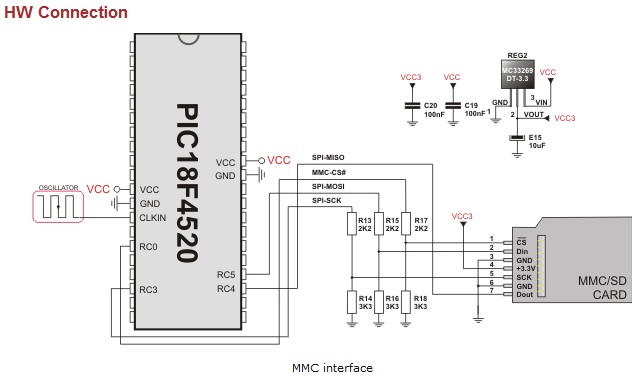

这里介绍一个简单的PIC单片机 读/写 MMC/SD 卡的小程序
// MMC module connections
sbit Mmc_Chip_Select           at LATC0_bit;  // for writing to output pin always use latch (PIC18 family)
sbit Mmc_Chip_Select_Direction at TRISC0_bit;
// eof MMC module connections
const LINE_LEN = 43;
char err_txt[20]       = "FAT16 not found";
char file_contents[LINE_LEN] = "XX MMC/SD FAT16 library by Anton Rieckertn";
char           filename[14] = "MIKRO00x.TXT";          // File names
unsigned short loop, loop2;
unsigned long  i, size;
char           Buffer[512];
// UART1 write text and new line (carriage return + line feed)
void UART1_Write_Line(char *uart_text) {
  UART1_Write_Text(uart_text);
  UART1_Write(13);
  UART1_Write(10);
// Creates new file and writes some data to it
void M_Create_New_File() {
  filename[7] = 'A';
  Mmc_Fat_Set_File_Date(2010, 4, 19, 9, 0, 0); // Set file date & time info
  Mmc_Fat_Assign(&filename, 0xA0);          // Find existing file or create a new one
  Mmc_Fat_Rewrite();                        // To clear file and start with new data
  for(loop = 1; loop <= 99; loop++) {
    UART1_Write('.');
    file_contents[0] = loop / 10 + 48;
    file_contents[1] = loop % 10 + 48;
    Mmc_Fat_Write(file_contents, LINE_LEN-1);   // write data to the assigned file
// Creates many new files and writes data to them
void M_Create_Multiple_Files() {
  for(loop2 = 'B'; loop2 <= 'Z'; loop2++) {
    UART1_Write(loop2);                  // signal the progress
    filename[7] = loop2;                 // set filename
    Mmc_Fat_Assign(&filename, 0xA0);     // find existing file or create a new one
    for(loop = 1; loop <= 44; loop++) {
// Opens an existing file and rewrites it
void M_Open_File_Rewrite() {
  filename[7] = 'C';
  Mmc_Fat_Assign(&filename, 0);
  Mmc_Fat_Rewrite();
  for(loop = 1; loop <= 55; loop++) {
// Opens an existing file and appends data to it
//               (and alters the date/time stamp)
void M_Open_File_Append() {
   filename[7] = 'B';
   Mmc_Fat_Set_File_Date(2010, 4, 19, 9, 20, 0);
   Mmc_Fat_Append();                                    // Prepare file for append
   Mmc_Fat_Write(" for mikroElektronika 2010n", 27);   // Write data to assigned file
// Opens an existing file, reads data from it and puts it to UART
void M_Open_File_Read() {
  char character;
  filename[7] = 'B';
  Mmc_Fat_Reset(&size);            // To read file, procedure returns size of file
  for (i = 1; i <= size; i++) {
    Mmc_Fat_Read(&character);
    UART1_Write(character);        // Write data to UART
// Deletes a file. If file doesn't exist, it will first be created
// and then deleted.
void M_Delete_File() {
  filename[7] = 'F';
  Mmc_Fat_Assign(filename, 0);
  Mmc_Fat_Delete();
// Tests whether file exists, and if so sends its creation date
// and file size via UART
void M_Test_File_Exist() {
  unsigned long  fsize;
  unsigned int   year;
  unsigned short month, day, hour, minute;
  unsigned char  outstr[12];
  filename[7] = 'B';       //uncomment this line to search for file that DOES exists
//  filename[7] = 'F';       //uncomment this line to search for file that DOES NOT exist
  if (Mmc_Fat_Assign(filename, 0)) {
    //--- file has been found - get its create date
    Mmc_Fat_Get_File_Date(&year, &month, &day, &hour, &minute);
    UART1_Write_Text(" created: ");
    WordToStr(year, outstr);
    UART1_Write_Text(outstr);
    ByteToStr(month, outstr);
    WordToStr(day, outstr);
    WordToStr(hour, outstr);
    WordToStr(minute, outstr);
    //--- file has been found - get its modified date
    Mmc_Fat_Get_File_Date_Modified(&year, &month, &day, &hour, &minute);
    UART1_Write_Text(" modified: ");
    //--- get file size
    fsize = Mmc_Fat_Get_File_Size();
    LongToStr((signed long)fsize, outstr);
    UART1_Write_Line(outstr);
  else {
    //--- file was not found - signal it
    UART1_Write(0x55);
    Delay_ms(1000);
    UART1_Write(0x55);
// Tries to create a swap file, whose size will be at least 100
// sectors (see Help for details)
void M_Create_Swap_File() {
  unsigned int i;
  for(i=0; i<512; i++)
    Buffer[i] = i;
  size = Mmc_Fat_Get_Swap_File(5000, "mikroE.txt", 0x20);   // see help on this function for details
  if (size) {
    LongToStr((signed long)size, err_txt);
    UART1_Write_Line(err_txt);
    for(i=0; i<5000; i++) {
      Mmc_Write_Sector(size++, Buffer);
      UART1_Write('.');
// Main. Uncomment the function(s) to test the desired operation(s)
void main() {
  #define COMPLETE_EXAMPLE         // comment this line to make simpler/smaller example
  ADCON1 |= 0x0F;                  // Configure AN pins as digital
  CMCON  |= 7;                     // Turn off comparators
  // Initialize UART1 module
  UART1_Init(19200);
  Delay_ms(10);
  UART1_Write_Line("PIC-Started"); // PIC present report
  // Initialize SPI1 module
  SPI1_Init_Advanced(_SPI_MASTER_OSC_DIV64, _SPI_DATA_SAMPLE_MIDDLE, _SPI_CLK_IDLE_LOW, _SPI_LOW_2_HIGH);
  // use fat16 quick format instead of init routine if a formatting is needed
  if (Mmc_Fat_Init() == 0) {
    // reinitialize spi at higher speed
    SPI1_Init_Advanced(_SPI_MASTER_OSC_DIV4, _SPI_DATA_SAMPLE_MIDDLE, _SPI_CLK_IDLE_LOW, _SPI_LOW_2_HIGH);
    //--- Test start
    UART1_Write_Line("Test Start.");
    //--- Test routines. Uncomment them one-by-one to test certain features
    M_Create_New_File();
    #ifdef COMPLETE_EXAMPLE
      M_Create_Multiple_Files();
      M_Open_File_Rewrite();
      M_Open_File_Append();
      M_Open_File_Read();
      M_Delete_File();
      M_Test_File_Exist();
      M_Create_Swap_File();
    #endif
    UART1_Write_Line("Test End.");
  else {
    UART1_Write_Line(err_txt); // Note: Mmc_Fat_Init tries to initialize a card more than once.
                               //       If card is not present, initialization may last longer (depending on clock speed)
