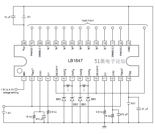

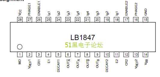

ATMEGA16A使用东芝LB1847芯片驱动步进电机
东芝LB1847引脚图:
0.png?imageView2/2/w/550
LB1847典型应用电路图
0.jpg?imageView2/2/w/550
0.png?imageView2/2/w/5500.png?imageView2/2/w/5500.png?imageView2/2/w/550

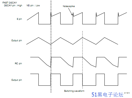

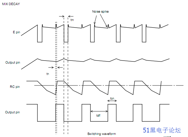

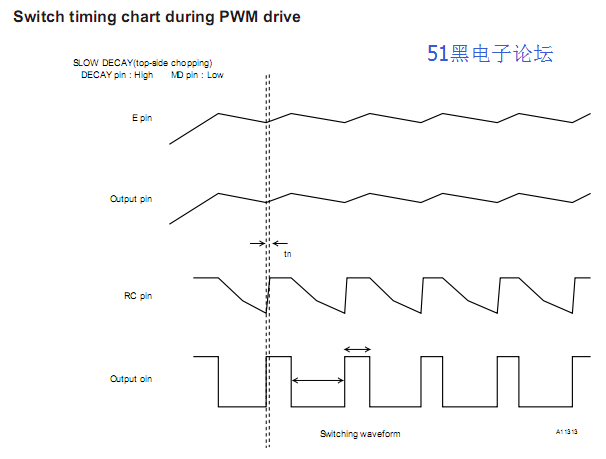

ton  : Output ON time
toff  : Output OFF time
tm  : FAST DECAY time in MIX DECAY mode
tn   : Noise cancelling time
MIX DECAY logic setting
DECAY pin : L
MD pin  :  1.5V to 4.0V voltage setting
     CR voltage and MD pin voltage are compared to select dual-side chopping
     or top-side chopping.
CR voltage > MD pin voltage: dual-side chopping
CR voltage < MD pin voltage: top-side choppi
