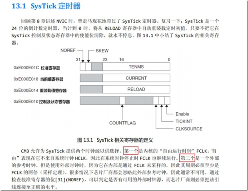

SysTick是CM内核独立的定时器,时钟可以用内核内部的,也可以用芯片厂家(ST)的时钟,参考《Cortex-M3权威指南》的第13章:

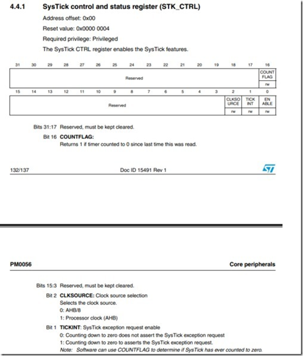

另外也可以考《STM32F10xxx Cortex-M3 programming manual.pdf》第4章CM3系统外设,从手册来看,ST应该只提供了内核外部时钟,而外部时钟又分成两种:HCLK/8 和 HCLK,

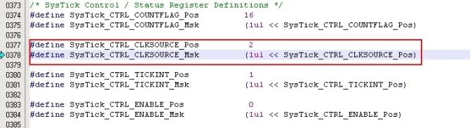

但是在V3.0中取消了stm32f10x_systick.c和stm32f10x_systick.h文件直接在core_cm3.h文件定义成内联函数
/* ##################################    SysTick function  ############################################ */
#if (!defined (__Vendor_SysTickConfig)) || (__Vendor_SysTickConfig == 0)
* @brief  Initialize and start the SysTick counter and its interrupt.
* @param   ticks   number of ticks between two interrupts
* @return  1 = failed, 0 = successful
* Initialise the system tick timer and its interrupt and start the
* system tick timer / counter in free running mode to generate
* periodical interrupts.
static __INLINE uint32_t SysTick_Config(uint32_t ticks)
  if (ticks > SysTick_LOAD_RELOAD_Msk)  return (1);            /* Reload value impossible */
  SysTick->LOAD  = (ticks & SysTick_LOAD_RELOAD_Msk) - 1;      /* set reload register */
  NVIC_SetPriority (SysTick_IRQn, (1<<__NVIC_PRIO_BITS) - 1);  /* set Priority for Cortex-M0 System Interrupts */
  SysTick->VAL   = 0;                                          /* Load the SysTick Counter Value */
  SysTick->CTRL  = SysTick_CTRL_CLKSOURCE_Msk |
                   SysTick_CTRL_TICKINT_Msk   |
                   SysTick_CTRL_ENABLE_Msk;                    /* Enable SysTick IRQ and SysTick Timer */
  return (0);                                                  /* Function successful */
#endif
而且是默认使用的AHB总线的时钟HCLK
宗合上述如果使用V3版本SysTick的话可以做以下操作,在不知道AHB总线的时钟的频下也可以直接算出加载值:
