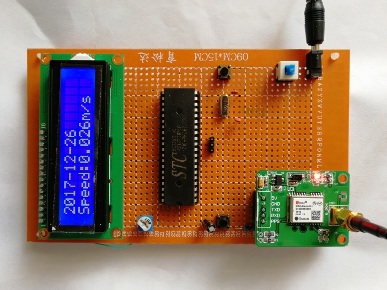

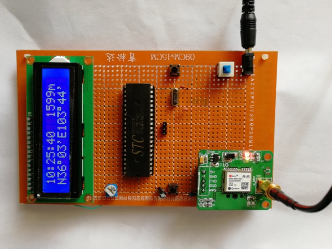

2019年12月31日 | 单片机GPS定位LCD1602液晶显示经纬度海拔及时间日期实物制作
2019-12-31 来源:51hei
制作出来的实物图如下:
单片机源程序如下:
#include "main.h"
#include "LCD1602.h"
#include "GPS.h"
//定义变量
unsigned char KEY_NUM = 0;
bit Page = 0;
unsigned char xdata Display_GPGGA_Buffer[68];
unsigned char xdata Display_GPRMC_Buffer[68];
bit Flag_OV = 0;
bit Flag_Calc_GPGGA_OK = 0;
bit Flag_Calc_GPRMC_OK = 0;
//主函数
void main()
        unsigned char i = 0;
        Init_LCD1602();
        LCD1602_write_com(0x80);                                                //指针设置
        LCD1602_write_word("Welcome to use!");
        Delay_ms(1000);
        Uart_Init();
        while(1)
                Scan_Key();
                if(Flag_GPS_OK == 1 && RX_Buffer[4] == 'G' && RX_Buffer[6] == ',' && RX_Buffer[13] == '.')                        //确定是否收到"GPGGA"这一帧数据
                        for( i = 0; i < 68 ; i++)
                                Display_GPGGA_Buffer[i] = RX_Buffer[i];
                        Hour = (Display_GPGGA_Buffer[7]-0x30)*10+(Display_GPGGA_Buffer[8]-0x30)+8;                        //UTC时间转换到北京时间                UTC+8
                                                                                                                                                                                                //0x30为ASCII转换为数字
                        if( Hour >= 24)                                //溢出
                                Hour %= 24;                                //获取当前Hour
                                Flag_OV = 1;                        //日期进位
                        else
                                Flag_OV = 0;
                        Min_High = Display_GPGGA_Buffer[9];
                        Min_Low = Display_GPGGA_Buffer[10];
                        Sec_High = Display_GPGGA_Buffer[11];
                        Sec_Low = Display_GPGGA_Buffer[12];
                        Flag_Calc_GPGGA_OK = 1;
                if(Page == 0 && Flag_Calc_GPGGA_OK == 1)
                        LED1 = ~LED1;
                        LCD1602_write_com(0x80);                        //设置指针
                        LCD1602_write_data(Hour/10+0x30);
                        LCD1602_write_data(Hour%10+0x30);
                        LCD1602_write_data(':');
                        LCD1602_write_data(Min_High);
                        LCD1602_write_data(Min_Low);
                        LCD1602_write_data(Sec_High);
                        LCD1602_write_data(Sec_Low);
                        LCD1602_write_word("  ");
                        LCD1602_write_data(Display_GPGGA_Buffer[54]);
                        LCD1602_write_data(Display_GPGGA_Buffer[55]);
                        LCD1602_write_data(Display_GPGGA_Buffer[56]);
                        LCD1602_write_data(Display_GPGGA_Buffer[57]);
                        LCD1602_write_word("m");
                        LCD1602_write_com(0x80+0x40);                        //设置指针
                        LCD1602_write_data(Display_GPGGA_Buffer[28]);                        //N 或者 S
                        LCD1602_write_data(Display_GPGGA_Buffer[17]);                        //纬度
                        LCD1602_write_data(Display_GPGGA_Buffer[18]);                        //纬度
                        LCD1602_write_data(0xdf);                                                                //度
                        LCD1602_write_data(Display_GPGGA_Buffer[19]);                        //纬度
                        LCD1602_write_data(Display_GPGGA_Buffer[20]);                        //纬度
                        LCD1602_write_word("'");                                                                //秒
                        LCD1602_write_data(Display_GPGGA_Buffer[42]);                        //E 或者 W
                        LCD1602_write_data(Display_GPGGA_Buffer[30]);                        //经度
                        LCD1602_write_data(Display_GPGGA_Buffer[31]);
