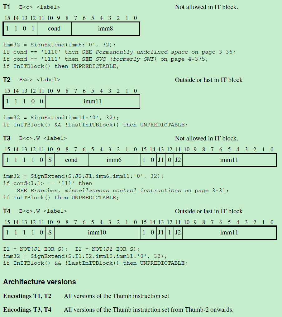

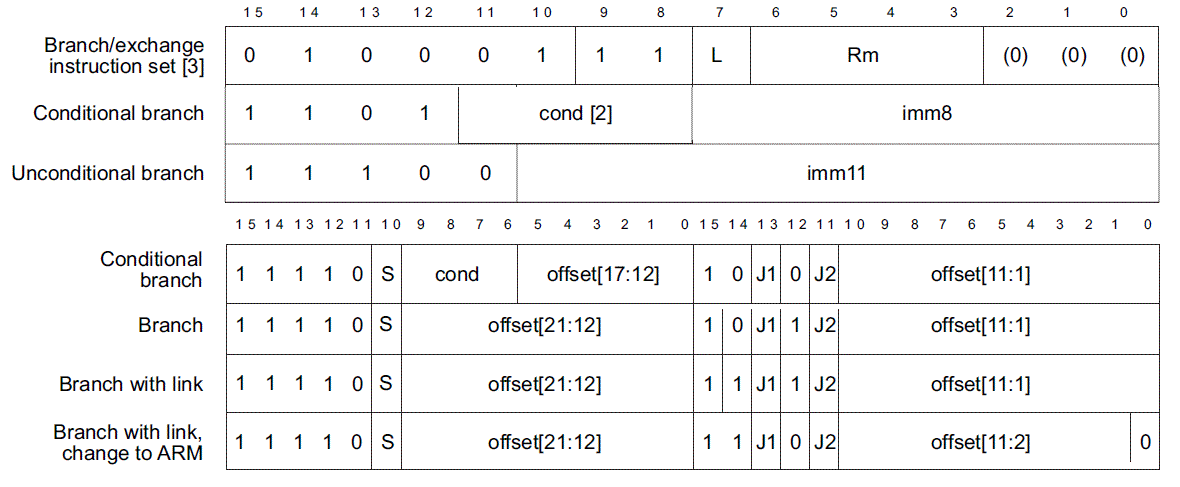

B.  -- Branch causes a branch to a target address
if ConditionPassed(cond) then
  EncodingSpecificOperations(PC, lable);
  BranchWritePC(PC + imm32);
// All versions of the Thumb instruction set
T1 : B : not allowed in IT block
T2 : B : outside or last in IT block
// All versions of the Thumb instruction set from Thumb-2 onwards.
T3 : B.W : not allowed in IT block
T4 : B.W : outside or last in IT block
Specifies the label of the instruction that is to be branched to.
The assembler calculates the required value of the offset
from the PC value of the B instruction to this label,
then selects an encoding that will set imm32 to that offset.
Allowed offsets are even numbers in the range
T1 : -256 to 254 : imm8
T2 : -2048 to 2046 : imm11
T3 : -1048576 to 1048574 : imm6 +  imm11
T4 : -16777216 to 16777214 : imm10 +  imm11

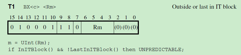

BX  -- Branch and Exchange causes a branch to an address and instruction set specified by a register.
T1 : BX  // Outside or last in IT block

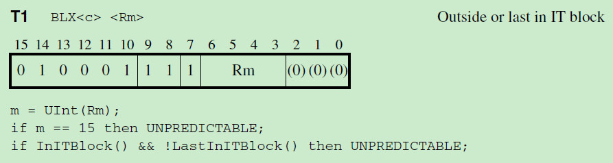

BLX (register) -- Branch and Exchange calls a subroutine at an address and instruction set specified by a register.
T1 : BLX  // Outside or last in IT block

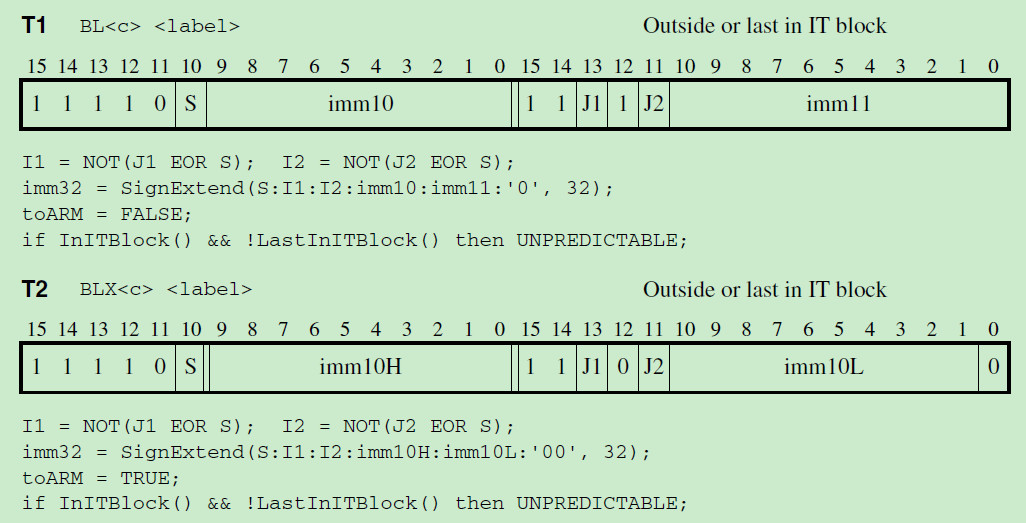

BL, BLX (immediate) -- Branch with Link (immediate) calls a subroutine at a PC-relative address.
T1 : BL
T2 : BLX
