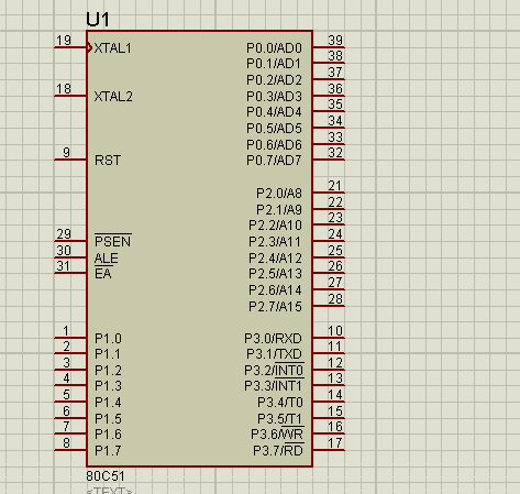

1.代码:
#include
typedef unsigned int  u16;
typedef unsigned char u8;
sbit led = P1^0;
void delay(u16 num)
    u16 x,y;
    for(x=num; x>0; x--)
        for(y=110; y>0; y--)
            ;//延时1ms
void main(void)
    led = 1;//LED输出模式
    while(1)
        led = 0;
        delay(500);
        led = 1;
        delay(500);
2.电路图:
