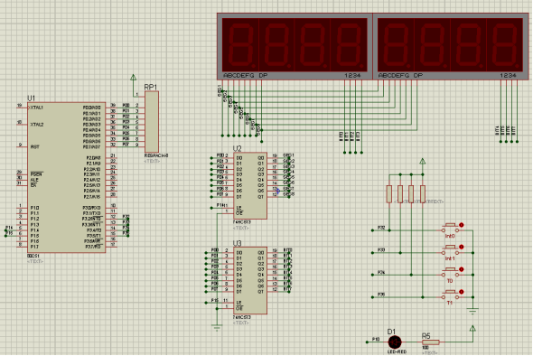

2020年01月11日 | DIY(码表)制作实验
2020-01-11 来源:eefocus
代码:
#include
typedef unsigned char u8;
typedef unsigned int  u16;
/********端口定义*********/
#define DATA P0
sbit seg_sel = P1^4;
sbit bit_sel = P1^5;
sbit start = P3^2;
sbit store = P3^3;
sbit diskey = P3^4;
sbit reset = P3^5;
sbit led = P1^0;
/********变量定义*********/
u16 tem_ms;
u8    n_ten_ms,n_sec,n_min;
u8    run_flag;//当run_flag为1,代表开始计数
u8  temp_buf[5][3];
u8  arr_pt;
u8 code seg_tab[]={
              0xc0,0xf9,0xa4,0xb0,
              0x99,0x92,0x82,0xf8,
              0x80,0x90,0x88,0x83,
              0xc6,0xa1,0x86,0x8e
u8 code bit_tab[]={
              0x10,0x20,0x40,0x80,
              0x01,0x02,0x04,0x08
void delay(unsigned int y)
    unsigned int x,z;
    for(x=y; x>0; x--)
        for(z=110; z>0; z--);
void display_led(u8 which_bit, u8 which_number)
    bit_sel = 1;//Q[7..0]=D[7..0]
    DATA = bit_tab[which_bit];
    bit_sel = 0;//BIT[7..0]=0x80
    seg_sel = 1;//Q[7..0]=D[7..0]
    DATA = seg_tab[which_number];
    seg_sel = 0;
void display(u8 which_bit, u8 which_number)
    u8 x,y;
    x = which_number/10;//分离十位
    y = which_number%10;//分离个位
    if (which_bit == 1)
        display_led(1, x);
        delay(2);
        display_led(0, y);
        delay(2);
    if (which_bit == 2)
        display_led(4, x);
        delay(2);
        display_led(3, y);
        delay(2);
    if (which_bit == 3)
        display_led(7, x);
        delay(2);
        display_led(6, y);
        delay(2);
void reflash (void)
    display(1, n_ten_ms);
    display(2, n_sec);
    display(3, n_min);
void main (void)
    TMOD = 0x01;//设置定时/计数器T0
    TH0 = (65535-10000) / 256;
    TL0 = (65535-10000) % 256;
    EA = 1;//开放总中断
    ET0 = 1;//开放定时器0的溢出中断
    //TR0 = 1;
    while (1)
        if (start == 0)
            delay(5);
            if (start == 0)
                run_flag = ~run_flag;
            } while(!start);
        if (run_flag)
            TR0 = 1; //开始计数
        else if (!run_flag)
            TR0 = 0;
            if (diskey == 0)
                delay (5);
                if (diskey == 0)
                    arr_pt --;
                    n_ten_ms = temp_buf[arr_pt][0];
                    n_sec = temp_buf[arr_pt][1];
                    n_min = temp_buf[arr_pt][2];
                } while (!diskey);
        if (reset == 0)
            delay(5);
            if (reset == 0)
                n_ten_ms = 0;
                n_sec = 0;
                n_min = 0;
            } while(!reset);
        if (store == 0)
            delay(5);
            if (store == 0)
                if ((arr_pt >=0) && (arr_pt< 5))
                    temp_buf[arr_pt][0] = n_ten_ms;
                    temp_buf[arr_pt][1] = n_sec;
                    temp_buf[arr_pt][2] = n_min;
                    arr_pt++;
            } while(!store);
        reflash();
void t0_server(void) interrupt 1
    n_ten_ms++;
    if (n_ten_ms >= 100)
        n_ten_ms = 0;
        n_sec++;
        if (n_sec >= 60)
            n_sec = 0;
            n_min++;
            if (n_min >= 60)
                n_min = 0;
电路图:
实验效果:
