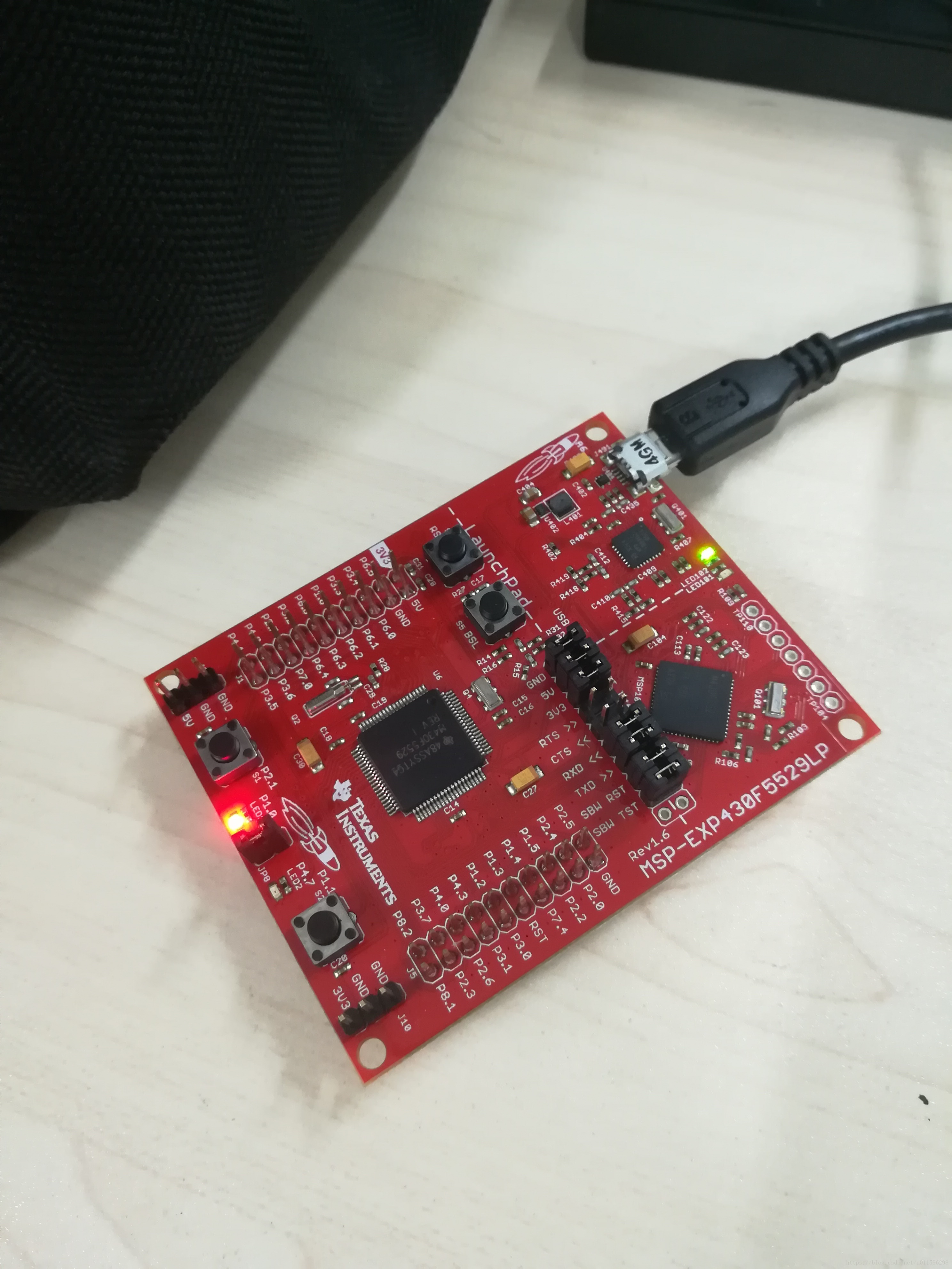

代码很简单,改编自TI官网例程,如下所示(编译环境为IAR):
#include "io430.h"
int main( void )
  volatile unsigned int i;
  // Stop watchdog timer to prevent time out reset
  WDTCTL = WDTPW + WDTHOLD;
  P1DIR |= BIT0;                            // P1.0 set as output
  while(1)                                  // continuous loop
    P1OUT ^= BIT0;                          // XOR P1.0
    for(i=50000;i>0;i--);                   // Delay
  //return 0;
下载后成功运行:
