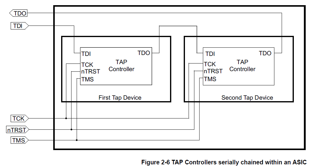

JTAG的接口是一种特殊的4/5个接脚接口连到芯片上 ,所以在电路版上的很多芯片可以将他们的JTAG接脚
通过Daisy Chain的方式连在一起,并且Probe只需连接到一个“JTAG端口”就可以访问一块印刷电路板上的所有IC。

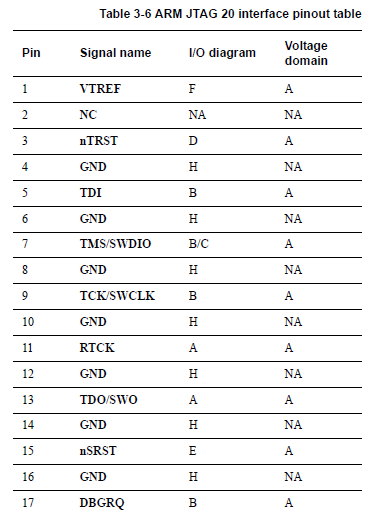

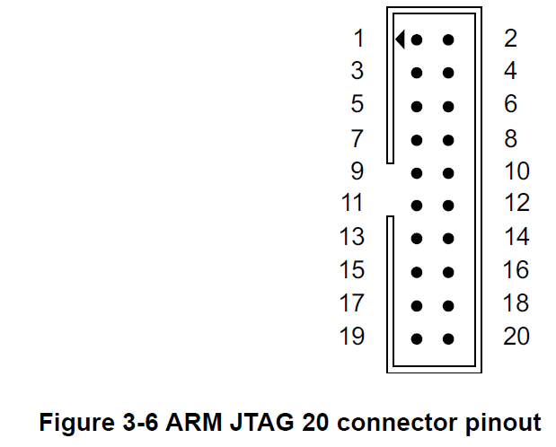

(VTREF) :接口信号电平参考电压一般直接连接Vsupply。
这个可以用来确定ARM的JTAG接口使用的逻辑电平(比如3.3V,还是5.0V)
Return Test Clock ( RTCK) :
可选项,由目标端反馈给仿真器的时钟信号,用来同步TCK信号的产生,不使用时直接接地。
System Reset ( nSRST):
可选项,与目标板上的系统复位信号相连,可以直接对目标系统复位。
同时可以检测目标系统的复位情况,为了防止误触发应在目标端加上适当的上拉电阻。

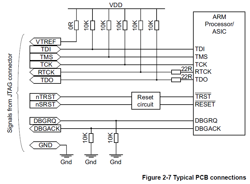

Note
• The signals TDI, TMS, TCK, RTCK and TDO are typically pulled up on the target board to keep them stable when the debug equipment is not connected.
• DBGRQ and DBGACK are typically pulled down on the target.
• If there is no RTCK signal provided on the processor, it can either be pulled to a fixed logic level or connected to the TCK signal to provide a direct loop-back.
• All pull-up and pull-down resistors must be in the range 1K-100KΩ.
• The VTREF signal is typically connected directly to the VDD rail. If a series resistor is used to protect against short-circuits, it must have a value no greater than 100Ω.
• To improve signal integrity, it is good practice to provide an impedance matching resistor on the TDO and RTCK outputs of the processor.
The value of these resistors, added to the impedance of the driver must be approximately equal to 50Ω.

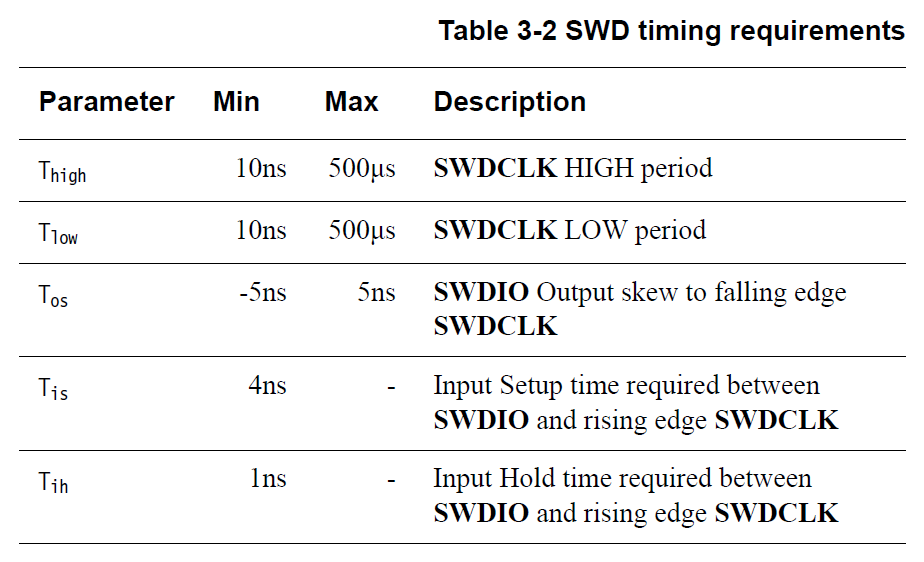

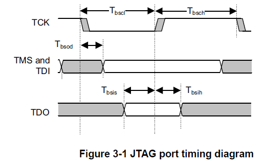

In a JTAG device that fully complies to IEEE1149.1-2001, TDI and TMS are sampled on the rising edge of TCK,
and TDO changes on the falling edge of TCK.
To take advantage of these properties, DSTREAM samples TDO on the rising edge of TCK and changes its TDI and TMS signals on the falling edge of TCK.
This means that with a fully compliant target, issues with minimum setup and hold times can always be resolved by decreasing the TCK frequency,
because this increases the separation between signals changing and being sampled.
Note
There are no separate timing requirements for adaptive clocking mode,
because the minimum Tbsch and Tbscl times are identical and are the same as for non-adaptive clocking.
Tbsis and Tbsih are relative to RTCK rising, and not TCK rising, as RTCK is used to sample TDO in adaptive clocking mode.
The only real timing difference is that in adaptive mode,
DSTREAM samples TDO on the rising edge of RTCK and not TCK, so TDO timing is relative to RTCK.
The debug software enables you to change the TCK frequency.
The TCK LOW:HIGH mark-space ratio is always 50:50.
The other parameters must be considered with the specific values of Tbscl and Tbsch that you have chosen.
The default values for an autoconfigured single-TAP system are, nominally, Tbscl=50ns and Tbsch=50ns.
• Tbsod is the maximum delay between the falling edge of TCK and valid levels on the TDI and TMS DSTREAM output signals.
The target samples these signals on the following rising edge of TCK
and so the minimum setup time for the target, relative to the rising edge of TCK, is Tbscl–Tbsod.
• Tbsis is the minimum setup time for the TDO input signal, relative to the rising edge of TCK when DSTREAM samples this signal.
The target changes its TDO value on the previous falling edge of TCK
and so the maximum time for the target TDO level to become valid, relative to the falling edge of TCK, is Tbscl–Tbsis.

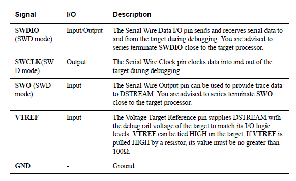

The SWDIO, SWCLK and SWO signals are typically pulled up on the target to keep them stable when the debug equipment is not connected.
• All pull-up resistors must be in the range 1K-100KΩ.
• To improve signal integrity, it is good practice to provide an impedance matching resistor on the SWDIO and SWO outputs of the processor.
