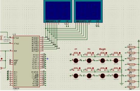

键盘扫描采用反转法读键:先从P2口的高4位输出零电平,从P2口的低4位读取键盘状态;再从P2口的低4位输出零电平,从P2口的高4位读取键盘状态,将两次读取的结果组合起来就可以得到当前按键的特征码(见程序中TABLE表)。有了这张表就可以编程,将它们转换成顺序码。用当前读得的特征码来顺序查表,用一单元记录查找次数。当在表中查到有该特征码时,它的位置(即查找次数)就是对应的顺序码。对应的键盘查键程序如下:
干货!8051单片机的反转法扫描键盘
KEY: MOV P2,#0FH ;用反转法查键
MOV A,P2
ANL A,#0FH
MOV B,A
MOV P2,#0F0H
MOV A,P2
ANL A,#0F0H
ORL A,B
CJNE A,#0FFH,KEY1
RET ;无键按下
KEY1: MOV B,A ;有键按下,存键码
MOV DPTR,#TABLE
MOV R3,#0FFH ;存顺序码单元初始化
KEY2: INC R3
MOV A,R3
MOVC A,@A+DPTR
CJNE A,B,KEY3 ;判键码,求顺序码
MOV A,R3 ;若找到键码,存顺序码
RET
KEY3: CJNE A,#0FFH,KEY2;判是否查完
RET ;已查完,键码未找到,以无按键处理
TABLE: DB 77H,7BH,0BBH ;按键特征码表
DB 0DBH,7DH,0BDH
DB 0DDH,7EH,0BEH
DB 0DEH,0B7H,0D7H
DB 0EEH,0EDH,0EBH
DB 0E7H,0C7H,0FFH
用C语言的写法
#include
#include
#include
#include
#include
#includeCC.h》
#define uchar unsigned char
#define uint unsigned int
keysCAN()
uchar i,h=0xfe;
for(i=4,P1=h;i》0;i--) //扫描
if((P1&0xf0)!=0xf0) //有键按下?
uchar a;
for(a=255;a》0;a--) //延时
uchar key,p;
p=P1;
for(key=0;key《16;key++) //查表
uchar code keytab[]={0xEE,0xDE,0xBE,0x7E, //键码表
0xED,0xDD,0xBD,0x7D,
0xEB,0xDB,0xBB,0x7B,
0xE7,0xD7,0xB7,0x77};
if(p==keytab[key]) //查到返回返回键号
P1=0xff;
return(key);
h=_crol_(h,1);
P1=h;
P1=0xff;
return(16); //没查到返回16
main()
{ while(1)
{P0=keyscan();
while(1)
