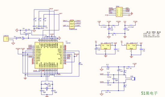

2020年02月05日 | 基于51单片机的vs1003 MP3模块原理图
2020-02-05 来源:51hei
电路原理图如下:
0.png?imageView2/2/w/550
单片机源程序如下:
* MP3模块测试程序
* 用途:MP3模块测试程序
*       vs1003 的硬件测试程序,主控芯片为STC12LE5A60S2
*       其他的微处理器(带SPI接口的)只需稍加修改即可适用
*       对于不带硬SPI接口的微处理器可以用IO进行SPI的时序模拟
* 作者                                        日期                                备注
* Huafeng Lin                        20010/09/10                        新增
* Huafeng Lin                        20010/09/10                        修改
#include "vs1003.h"
#include "MusicDataMP3.c"
#include
#define uchar unsigned char
#define uint unsigned int
#define ulong unsigned long
#define bool bit
#define true 1
#define flase 0
//针对SD卡读写板调整引脚
#define uint8 unsigned char
sbit  MP3_XRESET  = P3^2;
#define Mp3PutInReset()  { MP3_XRESET = 0; }
#define Mp3ReleaseFromReset()  { MP3_XRESET =1; }
sbit MP3_XCS = P3^3;
#define Mp3SelectControl()  { MP3_XCS = 0; }
#define Mp3DeselectControl()  { MP3_XCS = 1; }
sbit MP3_XDCS  = P3^4;
#define Mp3SelectData()                { MP3_XDCS = 0; }
#define Mp3DeselectData()        { MP3_XDCS = 1; }
sbit MP3_DREQ = P3^5;
sbit c_SPI_SI = P1^5;
sbit c_SPI_SO = P1^6;
sbit c_SPI_CLK = P1^7;
