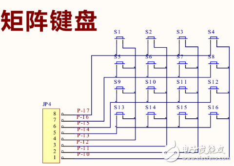

stm32矩阵键盘原理图
stm32矩阵键盘原理图及程序介绍
stm32矩阵键盘原理图及程序介绍
stm32矩阵键盘原理图及程序介绍
stm32矩阵键盘程序介绍

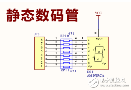

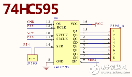

主要实现:扫描矩阵键盘,将检测到的数据通过spi 通信发送到数码管显示。
主要步骤:

RCC_APB2PeriphClockCmd(RCC_APB2Periph_GPIOA |RCC_APB2Periph_SPI1, ENABLE); //开启SPI1和GPIOA外设时钟
GPIO_InitStructure.GPIO_Pin = GPIO_Pin_4|GPIO_Pin_5|GPIO_Pin_6|GPIO_Pin_7;//设置SPI的四个引脚模式
GPIO_InitStructure.GPIO_Speed = GPIO_Speed_50MHz;
GPIO_InitStructure.GPIO_Mode = GPIO_Mode_AF_PP; //复用推挽输出
GPIO_Init(GPIOA, &GPIO_InitStructure);
GPIO_InitStructure.GPIO_Pin = GPIO_Pin_1; //设置GPIO A1管脚 用于锁存74HC595输出
GPIO_InitStructure.GPIO_Mode = GPIO_Mode_Out_PP;//推挽输出

3:编写矩阵键盘扫描函数KEY.c
u8 shu=16;
void KeyScan(void)
u8 i;
if((GPIO_ReadInputData(GPIOD) & 0x0f) != 0x0f )
Delay_MS(20);
GPIO_SetBits(GPIOD, GPIO_Pin_4 | GPIO_Pin_5| GPIO_Pin_6);
GPIO_ResetBits(GPIOD, GPIO_Pin_7);
switch(GPIO_ReadInputData(GPIOD) & 0x0f)
case 0x07: shu=0; break;
case 0x0b: shu=1; break;
case 0x0d: shu=2; break;
case 0x0e: shu=3; break;
GPIO_SetBits(GPIOD, GPIO_Pin_4 | GPIO_Pin_5| GPIO_Pin_7);
GPIO_ResetBits(GPIOD, GPIO_Pin_6);
case 0x07: shu=4; break;
case 0x0b: shu=5; break;
case 0x0d: shu=6; break;
case 0x0e: shu=7; break;
GPIO_SetBits(GPIOD, GPIO_Pin_4 | GPIO_Pin_6| GPIO_Pin_7);
GPIO_ResetBits(GPIOD, GPIO_Pin_5);
case 0x07: shu=8; break;
case 0x0b: shu=9; break;
case 0x0d: shu=10; break;
case 0x0e: shu=11; break;
GPIO_SetBits(GPIOD, GPIO_Pin_7 | GPIO_Pin_5| GPIO_Pin_6);
GPIO_ResetBits(GPIOD, GPIO_Pin_4);
case 0x07: shu=12; break;
case 0x0b: shu=13; break;
case 0x0d: shu=14; break;
case 0x0e: shu=15; break;
GPIO_SetBits(GPIOD, GPIO_Pin_0 | GPIO_Pin_1| GPIO_Pin_2| GPIO_Pin_3);
GPIO_ResetBits(GPIOD, GPIO_Pin_4 | GPIO_Pin_5| GPIO_Pin_6| GPIO_Pin_7);
while((i《50)&&((GPIO_ReadInputData(GPIOD) & 0x0f) != 0x0f))
i++;
Delay_MS(10);
4: SPI传送数据函数
void Display_Data(u8 data)
u8 i=data;
PAOut(1)=0;
SPI_I2S_SendData(SPI1,DSY_CODE[i]);
Delay_MS(2);
PAOut(1)=1;
Delay_MS(1000);
