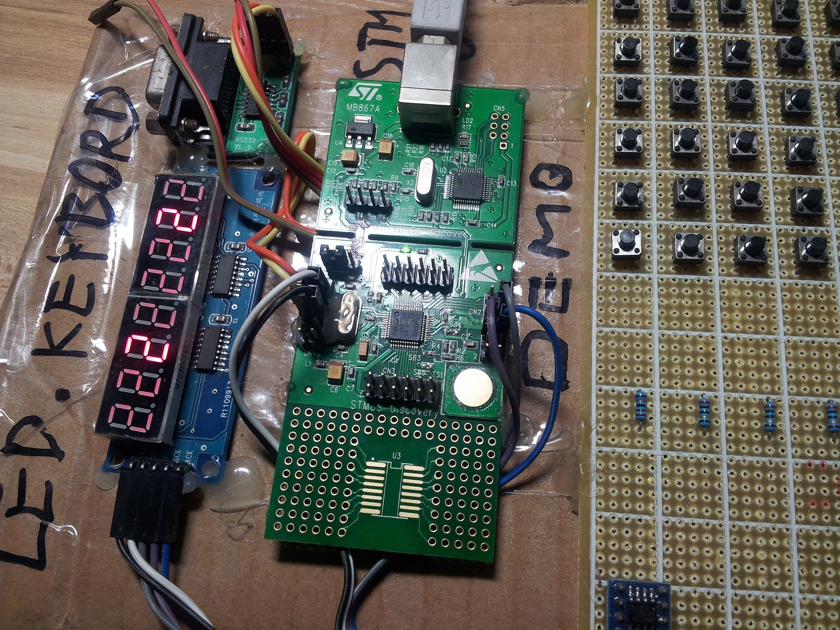

1: void GPIO_Configuration(void)
Add  GPIOA configuration
  GPIO_DeInit(GPIOD);
  /* Configure PD0 (LED1) as output push-pull low (led switched on) */
  GPIO_Init(GPIOD, GPIO_PIN_0, GPIO_MODE_OUT_PP_LOW_FAST);
  /* GPIOD reset */
  GPIO_DeInit(GPIOC);
  GPIO_Init(GPIOC, GPIO_PIN_5 , GPIO_MODE_OUT_PP_HIGH_SLOW);
  GPIO_Init(GPIOC, GPIO_PIN_6, GPIO_MODE_OUT_PP_HIGH_SLOW);
  GPIO_Init(GPIOC, GPIO_PIN_4, GPIO_MODE_OUT_PP_LOW_FAST);}
2: void HC595SendData(u8 SendData)
  send data to HC595 Using GPIOA+SPI
  GPIOC.6---- SER
  GPIOC.5---- SCLK
  GPIOC.4---- RCLK
#if Comm_MODE
  while (SPI_GetFlagStatus( SPI_FLAG_TXE) == RESET);
  SPI_SendData(SendData);
  while (SPI_GetFlagStatus(SPI_FLAG_RXNE) == RESET);
  SPI_ReceiveData(); /*读取因上面发送数据产生的无效数据*/
#else
  // 寄存器(可赋值):不优化290KHz,最高速度优化:319KHz
   u8 i;
   for(i=0; i<8; i++)
        if(SendData<ODR |= GPIO_PIN_6; //SER
        else                   GPIOC->ODR &=~GPIO_PIN_6;
        GPIOC->ODR |= GPIO_PIN_5; //SCLK
        GPIOC->ODR &=~GPIO_PIN_5;
   #endif
3: void sdata(void)
   Send 8 byte data to HC595
void sdata(void)
    HC595SendData(segbit[m]);
    HC595SendData(fseg[disbuf[m]]);
    GPIOC->ODR |= GPIO_PIN_4; //RCLK
    GPIOC->ODR &=~GPIO_PIN_4;
    m++;
    if(m==8)
      m=0;
1.declare m as globe variable
unsigned char m;
#define Comm_MODE        1/0
2.declare segbit , fseg and disbuf variable
  U8  fseg[]={0xc0,0xf9,0xa4,0xb0,0x99,0x92,0x82,0xf8,0x80,0x90};
unsigned char  segbit[]={0x80,0x40,0x20,0x10,0x08,0x04,0x02,0x01};
unsigned char  disbuf[8]={0,0,0,0,0,0,0,0};
3.should include the head file
   #include "stm8s_spi.h"
