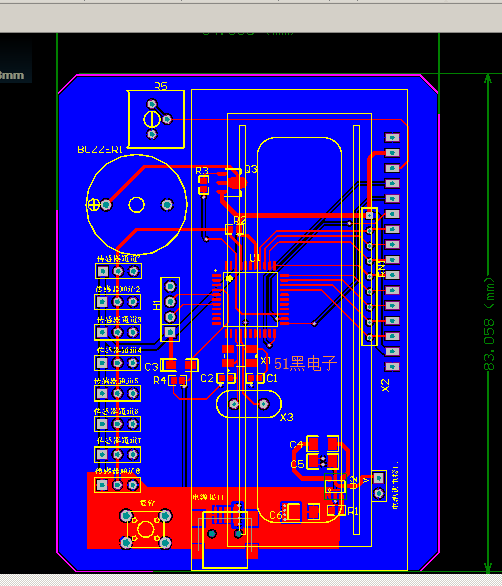

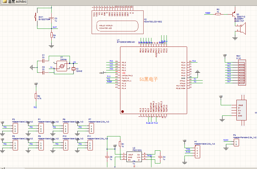

2020年02月25日 | 51单片机控制八个DS18B20温度传感器显示
2020-02-25 来源:51hei
单片机源程序如下:
#include
#include
#define                DATA        P1      //1602驱动端口
//ROM操作命令
#define                 READ_ROM                       0x33                    //读ROM
#define                 SKIP_ROM                       0xCC                    //跳过ROM
#define                 MATCH_ROM               0x55                    //匹配ROM
#define                 SEARCH_ROM              0xF0                    //搜索ROM
#define                 ALARM_SEARCH            0xEC                    //告警搜索
//存储器操作命令
#define                 ANEW_MOVE                     0xB8                    //重新调出E^2数据
#define                 READ_POWER              0xB4                    //读电源
#define                 TEMP_SWITCH             0x44                    //启动温度变换
#define                 READ_MEMORY             0xBE                    //读暂存存储器
#define                 COPY_MEMORY             0x48                    //复制暂存存储器
#define                 WRITE_MEMORY            0x4E                    //写暂存存储器
//数据存储结构
typedef struct tagTempData
        unsigned char                                         btThird;                                                        //百位数据
        unsigned char                                         btSecond;                                                        //十位数据
        unsigned char                                         btFirst;                                                        //个位数据
        unsigned char                                         btDecimal;                                                        //小数点后一位数据
        unsigned char                                        btNegative;                                                        //是否为负数
}TEMPDATA;
TEMPDATA m_TempData;
//引脚定义
sbit                                                         DQ = P2^7;                                                        //数据线端口
sbit                 RS=                P2^0;
sbit                 RW=                P2^1;
sbit                 E=                P2^2;
//DS18B20序列号,通过调用GetROMSequence()函数在P1口读出(读8次)
const unsigned char code ROMData1[8] = {0x28, 0x33, 0xC5, 0xB8, 0x00, 0x00, 0x00, 0xD7};        //U1
const unsigned char code ROMData2[8] = {0x28, 0x30, 0xC5, 0xB8, 0x00, 0x00, 0x00, 0x8E};        //U2
const unsigned char code ROMData3[8] = {0x28, 0x31, 0xC5, 0xB8, 0x00, 0x00, 0x00, 0xB9};        //U3
const unsigned char code ROMData4[8] = {0x28, 0x32, 0xC5, 0xB8, 0x00, 0x00, 0x00, 0xE0};        //U4
const unsigned char code ROMData5[8] = {0x28, 0x34, 0xC5, 0xB8, 0x00, 0x00, 0x00, 0x52};        //U5
const unsigned char code ROMData6[8] = {0x28, 0x35, 0xC5, 0xB8, 0x00, 0x00, 0x00, 0x65};        //U6
const unsigned char code ROMData7[8] = {0x28, 0x36, 0xC5, 0xB8, 0x00, 0x00, 0x00, 0x3C};        //U7
const unsigned char code ROMData8[8] = {0x28, 0x37, 0xC5, 0xB8, 0x00, 0x00, 0x00, 0x0B};        //U8
//判断忙指令
void Busy()
        DATA = 0xff;
        RS = 0;
        RW = 1;
           while(DATA & 0x80)
                E = 0;
                   E = 1;
           E = 0;
//写指令程序
void WriteCommand(unsigned char btCommand)
        Busy();
        RS = 0;
        RW = 0;
        E = 1;
        DATA = btCommand;
        E = 0;
//写数据程序
void WriteData(unsigned char btData)
        Busy();
        RS = 1;
        RW = 0;
        E = 1;
        DATA = btData;
        E = 0;
//清屏显示
void Clear()
        WriteCommand(1);
//初始化
void Init()
        WriteCommand(0x0c);        //开显示,无光标显示
        WriteCommand(0x06);        //文字不动,光标自动右移
        WriteCommand(0x38);        //设置显示模式:8位2行5x7点阵
//显示单个字符
void DisplayOne(bit bRow, unsigned char btColumn, unsigned char btData, bit bIsNumber)
        if (bRow)                 WriteCommand(0xc0 + btColumn);
        else                      WriteCommand(0x80 + btColumn);
        if (bIsNumber)         WriteData(btData + 0x30);
        else                   WriteData(btData);
//显示字符串函数
void DisplayString(bit bRow, unsigned char btColumn, unsigned char *pData)
        while (*pData != '')
                   if (bRow) WriteCommand(0xc0 + btColumn);        //显示在第1行
                   else            WriteCommand(0x80 + btColumn);        //显示在第0行
                WriteData(*(pData++));                                                //要显示的数据
                btColumn++;                                                                        //列数加一
//延时16us子函数
void Delay16us()
        unsigned char a;
        for (a = 0; a < 4; a++);
//延时60us子函数
void Delay60us()
        unsigned char a;
        for (a = 0; a < 18; a++);
