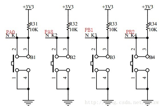

之前做终端按键的时候都是只做了一个,没有做多个,昨天在把所有按键都设置成中断模式的时候遇到问题,于是乎还跟一个网上的哥们进行了热议,后来还是我发现了问题!最终把问题给解决了!
我的按键的GPIO连接有点奇葩,他不是连续的,这可能就是竞赛板故意设置的难度吧!

我第一次在配置EXTI Line的时候这样配置!
GPIO_EXTILineConfig(GPIO_PortSourceGPIOA|GPIO_PortSourceGPIOB,
GPIO_PinSource0|GPIO_PinSource1|GPIO_PinSource2|GPIO_PinSource8);
大致一看,貌似很正常啊!但是问题就出在这!

我们来计算下:
GPIO_PortSourceGPIOA  |   GPIO_PortSourceGPIOB = 0x00 | 0x01 = 0x01 = GPIO_PortSourceGPIOB
GPIO_PinSource0 | GPIO_PinSource1  | GPIO_PinSource2 | GPIO_PinSource8 = 0x00 | 0x01 | 0x02 | 0x08 = 0x0b = GPIO_PinSource11
所以我最后初始化后的中断就成为:         GPIO_EXTILineConfig(GPIO_PortSourceGPIOB,GPIO_PinSource11);
最终让我事与愿违了。发现这个问题后,我仔细研究了一下GPIO_EXTILineConfig函数

明白了,没有什么好纠结的了!

这个问题搞清楚了,就没有什么容易出错的了,下面是代码:
void ITkey_init(void)
EXTI_InitTypeDef key_exti;
NVIC_InitTypeDef key_nvic;
GPIO_InitTypeDef key;
RCC->APB2ENR |= ((1<<0)|(1<<2)|(1<<3));
key.GPIO_Pin = GPIO_Pin_0|GPIO_Pin_8;
  key.GPIO_Mode = GPIO_Mode_IPD;
  GPIO_Init(GPIOA, &key);
key.GPIO_Pin = GPIO_Pin_1|GPIO_Pin_2;
  GPIO_Init(GPIOB, &key);
NVIC_PriorityGroupConfig(NVIC_PriorityGroup_2);
key_nvic.NVIC_IRQChannel = EXTI0_IRQn;
key_nvic.NVIC_IRQChannelCmd = ENABLE;
key_nvic.NVIC_IRQChannelPreemptionPriority = 0;
key_nvic.NVIC_IRQChannelSubPriority = 1;
NVIC_Init(&key_nvic);
GPIO_EXTILineConfig(GPIO_PortSourceGPIOA,GPIO_PinSource0);
key_exti.EXTI_Line = EXTI_Line0;
key_exti.EXTI_LineCmd = ENABLE;
key_exti.EXTI_Mode = EXTI_Mode_Interrupt;
key_exti.EXTI_Trigger = EXTI_Trigger_Rising;
EXTI_Init(&key_exti);
key_nvic.NVIC_IRQChannel = EXTI9_5_IRQn;
GPIO_EXTILineConfig(GPIO_PortSourceGPIOA,GPIO_PinSource8);
key_exti.EXTI_Line = EXTI_Line8;
key_nvic.NVIC_IRQChannel = EXTI1_IRQn;
GPIO_EXTILineConfig(GPIO_PortSourceGPIOB,GPIO_PinSource1);
key_exti.EXTI_Line = EXTI_Line1;
key_nvic.NVIC_IRQChannel = EXTI2_IRQn;
GPIO_EXTILineConfig(GPIO_PortSourceGPIOB,GPIO_PinSource2);
key_exti.EXTI_Line = EXTI_Line2;
