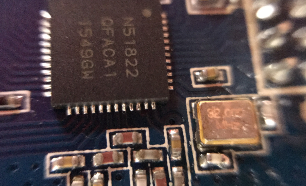

硬件平台为微雪BLE400的(将原来的16mhz晶振改为32mhz。两个旁电容改为22pf)

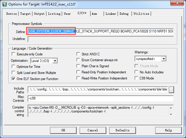

以nRF51_SDK_10.0.0_dc26b5eexamplesble_peripheralble_app_uart项目为例
在main.c中进行修改
#if defined( USB_SYSTEM_CLOCK_32MHZ)
#define DEVICE_NAME                     "Nordic_UART_32mhz"                               /**< Name of device. Will be included in the advertising data. */
#else
#define DEVICE_NAME                     "Nordic_UART"                               /**< Name of device. Will be included in the advertising data. */
#endif//USB_SYSTEM_CLOCK_32MHZ
#if defined (USB_SYSTEM_CLOCK_32MHZ)
    setClock();

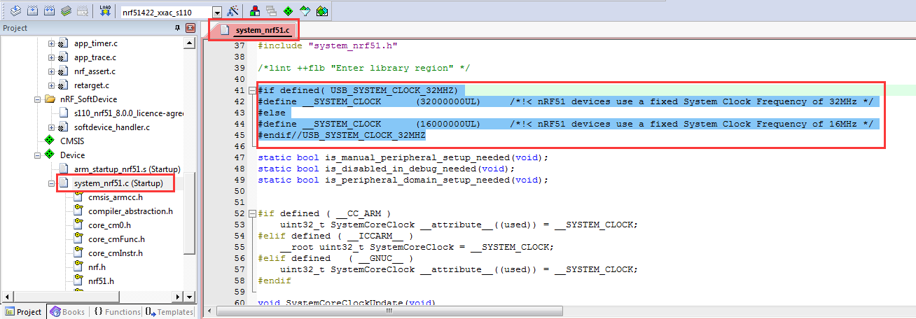

修改system_nrf51.C
#define __SYSTEM_CLOCK      (32000000UL)     /*!< nRF51 devices use a fixed System Clock Frequency of 32MHz */
#else
#define __SYSTEM_CLOCK      (16000000UL)     /*!< nRF51 devices use a fixed System Clock Frequency of 16MHz */
后面的测试的步骤和16mhz步骤相同。
