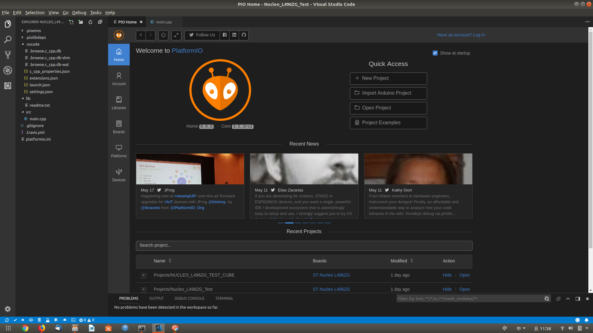

( 补充:VSCode的PlatformIO IDE插件里Platform选项安装“ST STM32”家目录下会自动安装相应工具,看下面:
~/.platformio/packages/toolchain-gccarmnoneeabi/bin/arm-none-eabi-gcc -v
嗯。不用另外装arm-none-eabi工具集了,如果你用PlatformIO插件的话。  )

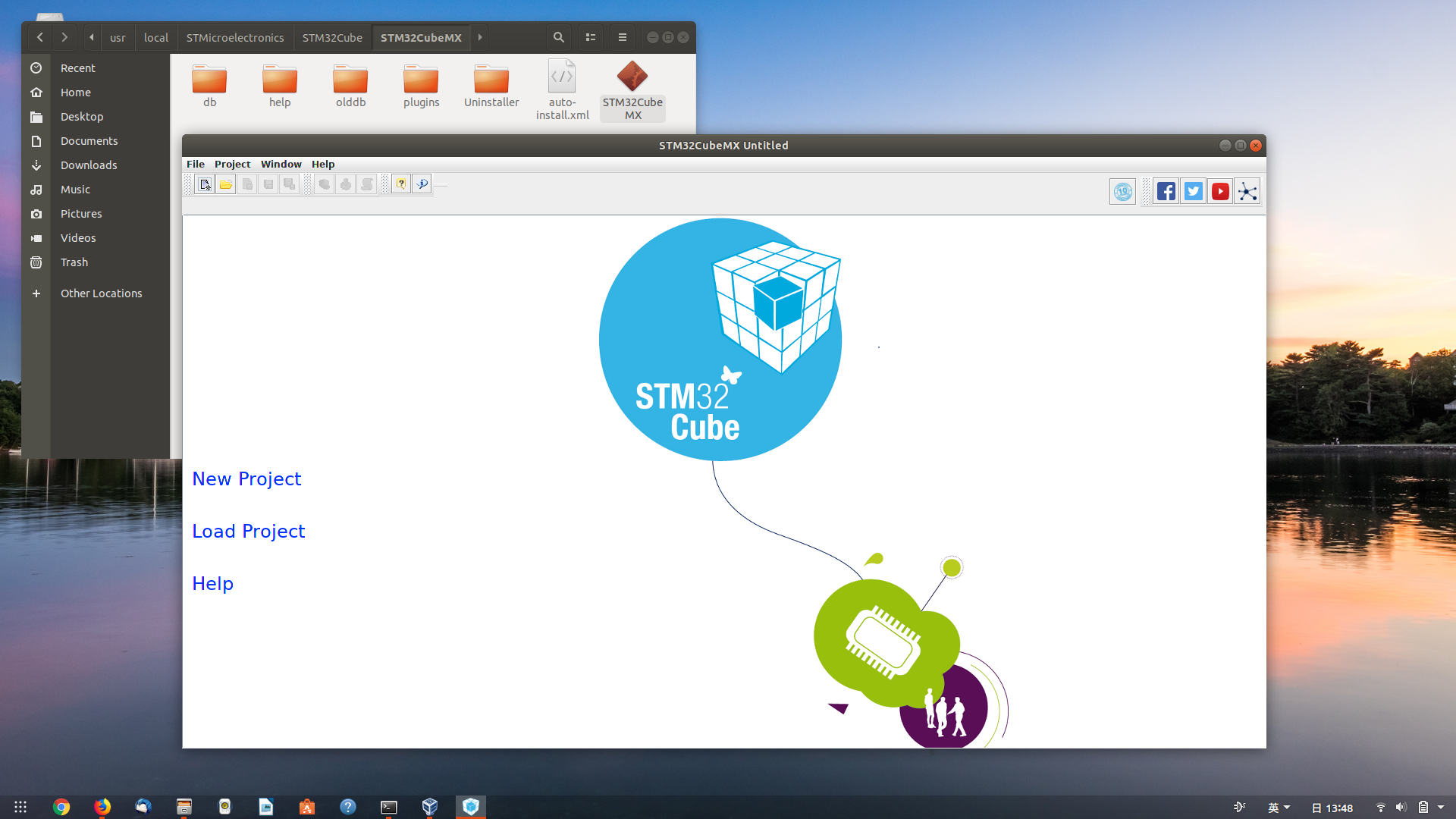

Stm32CubeMX: 官网下载,解压后进入文件夹
sudo apt-get install default-jre
sudo ./SetupSTM32CubeMX-x.xx.x.linux

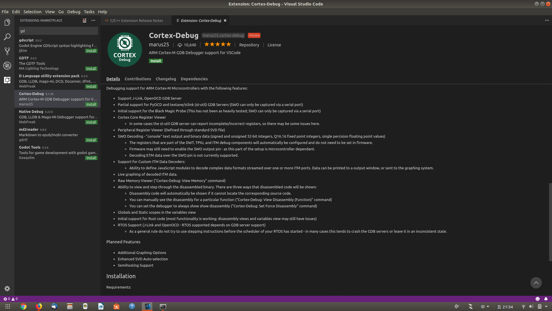

 cortex-debug插件(感觉不错~):
          launch.json例子:
    "version": "0.2.0",
    "configurations": [
            "name": "Cortex Debug",
            "cwd": "${workspaceRoot}",
            "executable": "build/L496ZGTx_LPUASRT.elf",
            "request": "launch",
            "type": "cortex-debug",
            "servertype": "openocd",
            "BMPGDBSerialPort": "/dev/ttyACM0",
            "runToMain": true,
            "device": "STM32L496ZG",
            //"preLaunchTask": "build-elf",
            "configFiles": [
                "board/st_nucleo_l4.cfg"
PlatformIO IDE插件(感觉支持的东西比较新):请戳http://docs.platformio.org/en/latest/ide/vscode.html#quick-start
