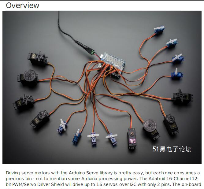

2020年09月07日 | PCA9685 PWM舵机驱动板16路模块 IIC接口
2020-09-07 来源:51hei
16路模块 PWM舵机驱动板 控制器 机器人 IIC接口 使用说明书
AdafruitPWMServoDriverLibrary单片机源程序如下:
  This is a library for our Adafruit 16-channel PWM & Servo driver
  Pick one up today in the adafruit shop!
  These displays use I2C to communicate, 2 pins are required to
  interface. For Arduino UNOs, thats SCL -> Analog 5, SDA -> Analog 4
  Adafruit invests time and resources providing this open source code,
  please support Adafruit and open-source hardware by purchasing
  products from Adafruit!
  Written by Limor Fried/Ladyada for Adafruit Industries.
  BSD license, all text above must be included in any redistribution
