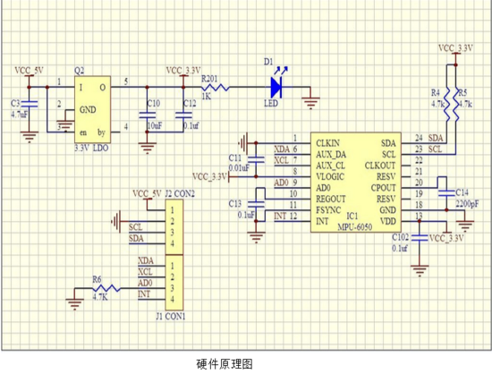

2020年09月11日 | 51单片机MPU6050数字陀螺仪与LCD12864显示
2020-09-11 来源:51hei

// 定义MPU6050内部地址
#define SMPLRT_DIV      0x19    //陀螺仪采样率,典型值:0x07(125Hz)
#define CONFIG          0x1A    //低通滤波频率,典型值:0x06(5Hz)
#define GYRO_CONFIG     0x1B    //陀螺仪自检及测量范围,典型值:0x18(不自检,2000deg/s)
#define ACCEL_CONFIG    0x1C    //加速计自检、测量范围及高通滤波频率,典型值:0x01(不自检,2G,5Hz)
#define ACCEL_XOUT_H    0x3B
#define ACCEL_XOUT_L    0x3C
#define ACCEL_YOUT_H    0x3D
#define ACCEL_YOUT_L    0x3E
#define ACCEL_ZOUT_H    0x3F
#define ACCEL_ZOUT_L    0x40
#define TEMP_OUT_H      0x41
#define TEMP_OUT_L      0x42
#define GYRO_XOUT_H     0x43
#define GYRO_XOUT_L     0x44
#define GYRO_YOUT_H     0x45
#define GYRO_YOUT_L     0x46
#define GYRO_ZOUT_H     0x47
#define GYRO_ZOUT_L     0x48
#define PWR_MGMT_1      0x6B    //电源管理,典型值:0x00(正常启用)
#define WHO_AM_I            0x75    //IIC地址寄存器(默认数值0x68,只读)
#define SlaveAddress    0xD0    //IIC写入时的地址字节数据,+1为读取
