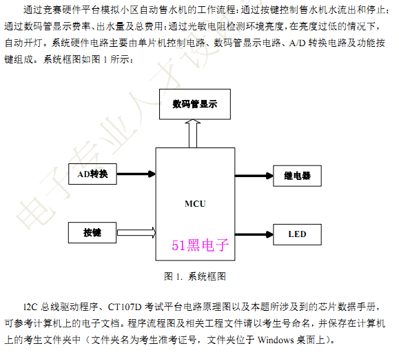

2020年10月10日 | 51单片机自动售水机程序
2020-10-10 来源:51hei
单片机源程序如下:
#include "stc.h"
#include "button.h"
#include "smg.h"
#include "AT24C02.h"
sbit led1=P0^0;
sbit bell=P0^6;
sbit relay=P0^4;
unsigned char flag_s7,flag_s6;
int money=0,amount=0;//价格 容量
unsigned char count,flag_count;
unsigned char state;         //控制数码管两种显示界面 按键控制
#define EXE_EN P2 = (P2&0X1F)|0XA0;  P2 &= 0X1F
void init_time0()          //1微妙加1
        TMOD=0x01;
        TH0=(65536-50000)/256;//定时50ms
        TL0=(65536-50000)%256;
        ET0=1;
        //TR0=1;
        EA=1;
void time0() interrupt 1
   count++;
   if(count==20)
   count=0;
   flag_count=1;
void key()
        unsigned char kk=keyboard();
        unsigned char guan=get_lux(0x41);
        if(guan<64)
            P0=0xff;
            P2&=0x1f;
            P2|=0x80;
            led1=0;//灯l2亮
                P2&=0x1f;
        if(guan>=64)
                P0=0xff;
            P2&=0x1f;
            P2|=0x80;
            led1=1;//灯l1灭
                P2&=0x1f;
        if(kk==7)
        flag_s7=1;
        state=1;
        TR0=1;                  //启动定时器
        if(kk==6)
                flag_s6=1;
                state=2;
        if(flag_s7)
          flag_s7=0;bell=0;relay=1;EXE_EN;
        if(flag_s6)
         TR0=0;                 //关闭定时器
         flag_s6=0;bell=0;relay=0;EXE_EN;
        if(state==1)
            display_s(1,0); display(2,5); display(3,0);
                display(4,amount/100); display_s(5,amount%100/10); display(6,amount%10); display(7,0);
        if(state==2)
                display(4,money/1000); display_s(5,money%1000/100); display(6,money%100/10); display(7,money%10);
        if(flag_count==1)
                flag_count=0;
                money=money+5;
                amount=amount+1;
        if(amount==9990){flag_s6=1;state=2;}
void main()
    init_time0();
        while(1)
          key();
