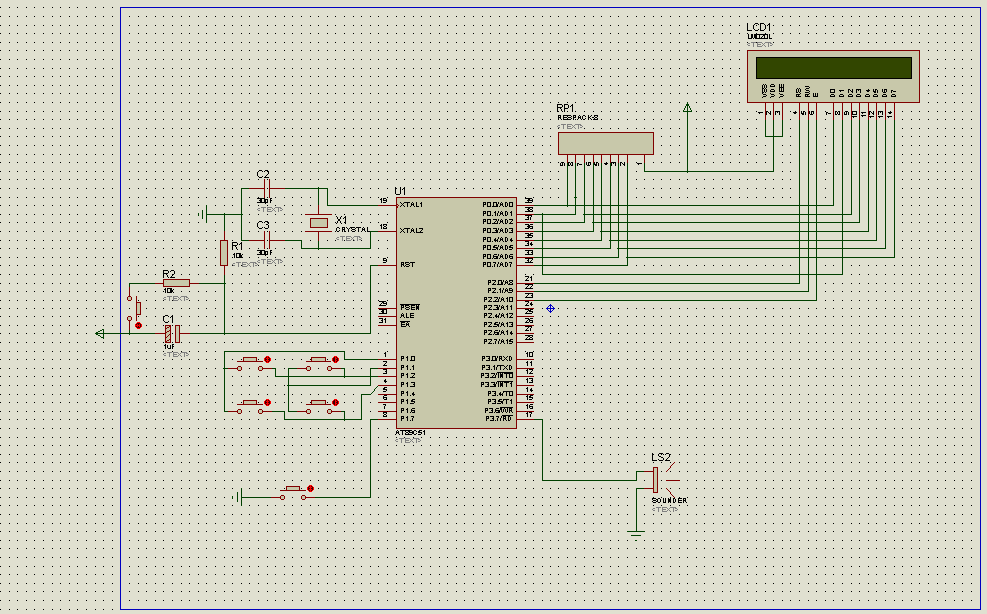

2020年10月10日 | 基于AT89C51制作的数字音乐盒
2020-10-10 来源:51hei
#include
#define uchar unsigned char
#define uint unsigned int
#define  LCDPORT P0
uchar code tab[]="Press key";
uchar code tab1[]="Select song";
uchar code tab2[]="First Song" ;
uchar code tab3[]="butterfly";
uchar code tab4[]="Second Song"        ;
uchar code tab5[]="Jingle bell ";
uchar code tab6[]="Third Song" ;
uchar code tab7[]="Yesterday";
uchar code tab8[]="Forth Song" ;
uchar code tab9[]="Youth League";
sbit LCDE=P2^2;
sbit LCDRW=P2^1;
sbit LCDRS=P2^0;
#define SYSTEM_OSC                 12000000        //定义晶振频率12000000HZ
#define SOUND_SPACE         4/5                 //定义普通音符演奏的长度分率,//每4分音符间隔
sbit    BeepIO    =           P3^7;                //定义输出管脚
sbit        K1=P1^7;
unsigned int  code FreTab[12]  = { 262,277,294,311,330,349,369,392,415,440,466,494 }; //原始频率表
unsigned char code SignTab[7]  = { 0,2,4,5,7,9,11 };                                                                   //1~7在频率表中的位置
unsigned char code LengthTab[7]= { 1,2,4,8,16,32,64 };
