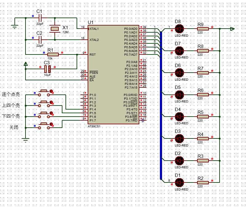

2020年10月13日 | 单片机四组按键控制LED的不同状态
2020-10-13 来源:51hei
单片机源程序如下:
#include
#define uchar unsigned char
#define uint unsigned int
void DelayMS(uint x)
         uchar t;
        while(x--)
                for(t=0;t<120;t--);
void main()
         uchar k,t,Key_State;
        P0 = 0xff;
        P1 = 0xff;
        while(1)
                 t = P1;
                         DelayMS(10);
                        if(t != P1)
                                continue;
                        Key_State = ~t >> 4;
                        k = 0;
                        while(Key_State != 0)
                                 k++;
                                Key_State >>= 1;
                        switch(k)
                                 case 1: if(P0 == 0x00)
                                                P0 = 0xff;
                                                P0 <<= 1;
                                                DelayMS(200);
                                                break;
                                case 2: P0 = 0xf0;
                                                break;
                                case 3: P0 = 0x0f;
                                                break;
                                case 4: P0 = 0xff;
