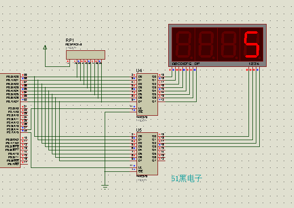

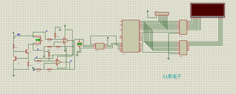

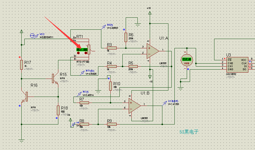

2020年12月24日 | 单片机+ADC0832热电阻PT100测温程序
2020-12-24 来源:51hei
单片机源程序如下:
#include
#include
#define uchar unsigned char
#define uint unsigned int
sbit cs=P1^2;
sbit clk=P1^0;
sbit di=P1^1;
uchar num,num1,i,a,b,c,e,f,g;
int wendu;
sbit we = P2^7;        //位定义数码管位选锁存器接口
sbit du = P2^6;        //位定义数码管段选锁存器接口
sbit pay_plus=P1^4;
sbit pay_minus=P1^3;
sbit confirm=P1^5;
sbit LED=P1^6;
int TimerCount=0,time_count=0;
int L_set_wendu=0;
int H_set_wendu=20;
bit   confirm_scan=1;
bit   pay_plus_scan=1;
bit   pay_minus_scan=1;
//数码管段选表
uchar code leddata[]={
                0x3F,  //"0"
                0x06,  //"1"
                0x5B,  //"2"
                0x4F,  //"3"
                0x66,  //"4"
                0x6D,  //"5"
                0x7D,  //"6"
                0x07,  //"7"
                0x7F,  //"8"
                0x6F,  //"9"
                0x40,  //"-"
                0x00,  //熄灭
                0x00  //自定义
void delay(unsigned long x)
        uchar y;
        for(;x>0;x--)
                for(y=110;y>0;y--);
uchar ADC0832()
        cs=1;
        clk=0;
        cs=0;
        di=1;
        clk=1;
        clk=0;
        di=1;
        clk=1;
        clk=0;
        di=0;
        clk=1;
        clk=0;
        di=1;
        for(i=0;i<8;i++)
                clk=1;
                clk=0;
                num=num<<1;
                num|=(uchar)di;
        cs=1;
        return num;
int SG=0;
void Key()
  if(confirm!=confirm_scan)
                        if(confirm==0)  //下降沿
                        {   SG++;
//                                step++;
                 if(SG>=3)
                                            SG=0;
                       confirm_scan=confirm;
void Timer0_Init(void)
        TMOD |= 0x01;
    TH0=(65536-50000)/256;
        TL0=(65536-50000)%256;
        EA = 1;
        ET0 = 1;
        TR0 = 1;
void main()
        pay_plus=1;
    pay_minus=1;
    confirm=1;
        Timer0_Init();
        while(1)
        {Key();
                ADC0832();
                if(num<=38)
                        wendu=num-69;
                if(num>38&&num<=70)
                        wendu=num-70;
                if(num>70)
                        wendu=num-71;
        if(SG==0)
        if(wendu>=0)
                        a=wendu/100;
                        b=wendu%100/10;
                        c=wendu%10;
                        if(a>0)
                                P0 = 0xfd;//1111 1101  只选通第二位数码管
                                we = 1;        //打开位选
                                we = 0;        //关闭位选
                                P0 = leddata[a]; //显示2
                                du = 1;//打开段选
                                du = 0;        //关闭段选
                                delay(2);//延时
                        if(a!=0||b>0)
                                P0 = 0xfb;// 1111 1011只选通第三位数码管
                                we = 1;        //打开位选
                                we = 0;        //关闭位选
                                P0 = leddata[b]; //显示3
                                du = 1;//打开段选
                                du = 0;        //关闭段选
                                delay(2);//延时
                        P0 = 0xf7;//1111 0111  只选通第四位数码管
                        we = 1;        //打开位选
                        we = 0;        //关闭位选
                        P0 = leddata[c]; //显示4
                        du = 1;//打开段选
                        du = 0;        //关闭段选
                        delay(2);//延时
        if(SG==1)    //设定上限报警
                            P0 = 0xfe;//1111 0111  只选通第二位数码管
                                we = 1;        //打开位选
                                we = 0;        //关闭位选
