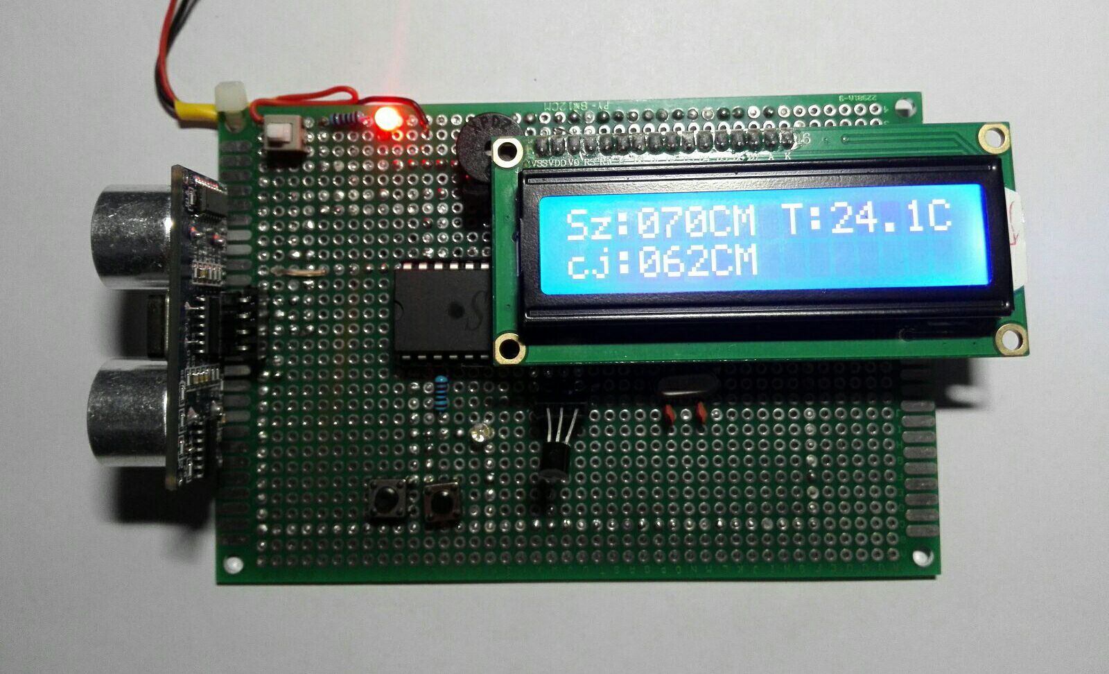

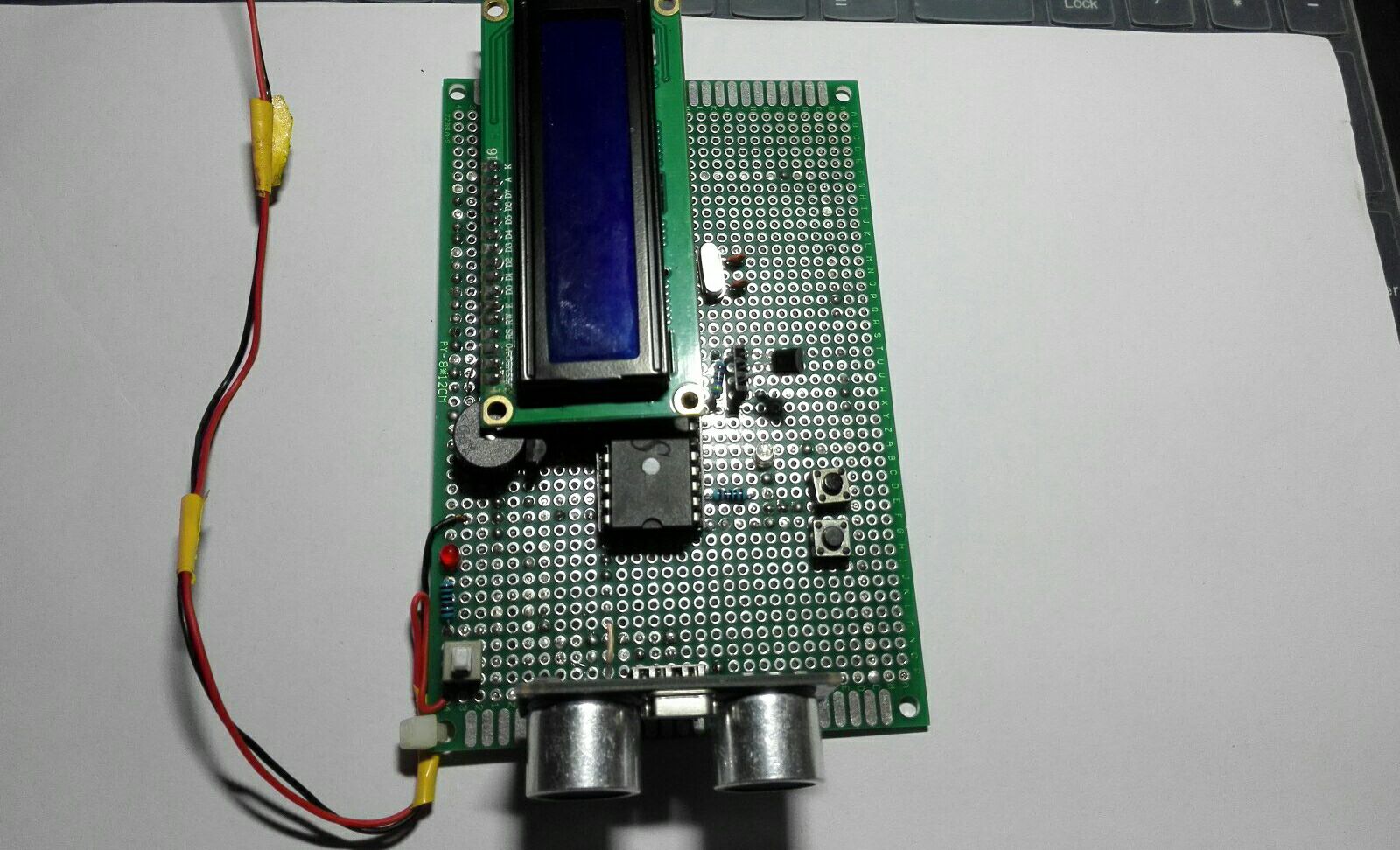

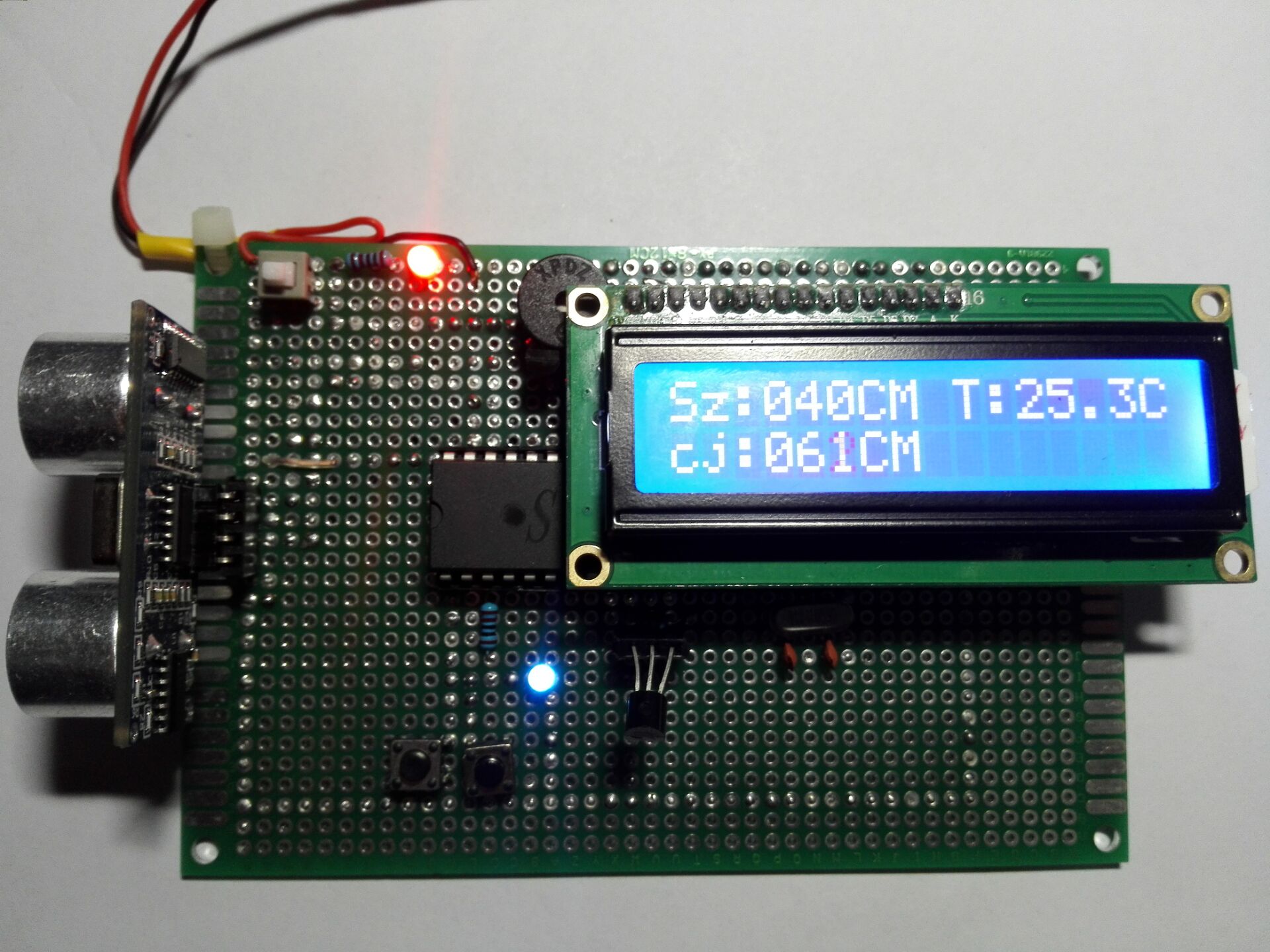

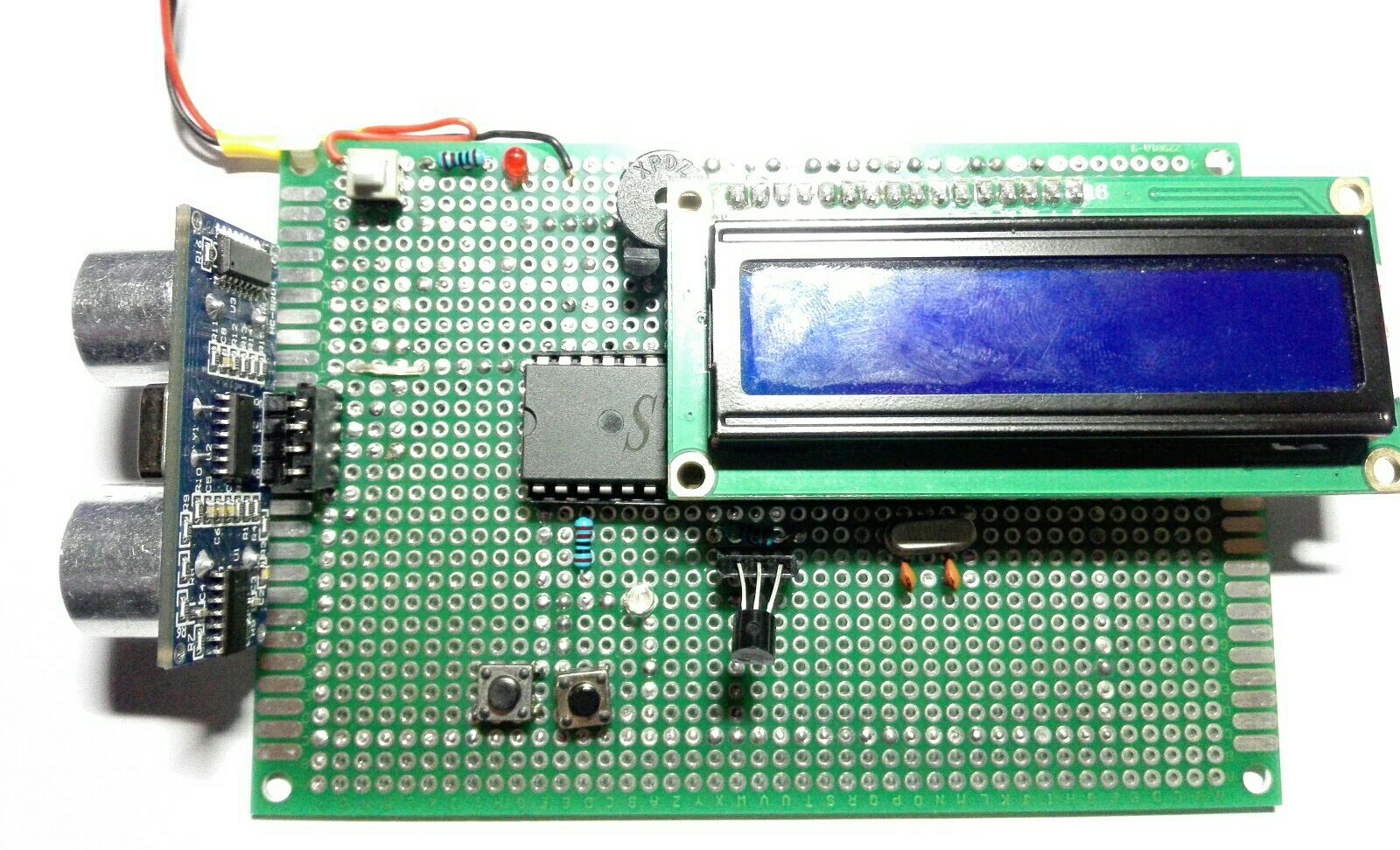

2021年01月10日 | 超声波测距+温度+报警的单片机代码
2021-01-10 来源:51hei
可以测当前距离,当超过阈值距离时,蜂蜜器报警,并且实时显示温度数据
制作出来的实物图如下:
单片机源程序如下:
#include
#include
#define uchar unsigned char
#define uint unsigned int
int num=0;
unsigned char table[]={"0123456789"};//显示的数值
//   1602的引脚定义
sbit RW=P2^5;
sbit RS=P2^6;
sbit E=P2^7;
//报警引脚定义
sbit feng=P2^4;
sbit led=P1^2;
sbit key1=P1^0;
sbit key2=P1^1;
int numm=0,nnum=0;
void delayms(unsigned int ms)
        unsigned char i=100,j;
        for(;ms;ms--)
                while(--i)
                        j=10;
                        while(--j);
bit flag;           //温度变量
uint temp;
sbit ds=P1^3;  //温度引脚
//超声波位定义
sbit Trig = P2^1;
sbit Echo = P2^0;
uint time=0;
unsigned long S=0;
bit flagg=0;
void delay2(uchar p)
          uchar l,k;
           for(l=p;l>0;l--)
              for(k=110;k>0;k--);
void delay(uchar z)
    while(z--);
//温度初始化函数
void ds_reste()
        ds=1;
        delay(5);
        ds=0;
        delay(80);
        ds=1;
        delay(14);
        if(ds==0)                 //判断ds总线被拉低
        flag=1;
        else
        flag=0;
        delay(20);
//读一位字节
bit ds_read_byte()
         bit dat;
         ds=0;
         _nop_();
         _nop_();
         ds=1;
         _nop_();
         dat=ds;
         delay(10);
         return dat;
//读一位字节
uchar ds_read()
        uchar i,j,k;
      for(i=0;i<8;i++)
        j=ds_read_byte();
        k=(j<<7)|(k>>1);
         return k;
//写入数据
void ds_write(uchar dat)
         uchar i;
         for(i=0;i<8;i++)
         ds=0;
         _nop_();
         ds=dat&0x01;
         delay(6);
         ds=1;
         dat=dat>>1;
         delay(6);
//读取温度
uint read_temp()
        uchar a,b;
        ds_reste();
        ds_write(0xcc);
        ds_write(0xbe);
        a=ds_read();
        b=ds_read();
        temp=b;
        temp=temp<<8;
        temp=temp|a;
        temp=temp*0.0625*10+0.5;
        return temp;
//写入命令1602
void write_com(uchar com)
        RS=0;
        RW=0;
        E=0;
        P0=com;
        delay2(5);
        E=1;
        delay2(5);
        E=0;
//写入数据 1602
void write_data(uchar date)
        RS=1;
        RW=0;
        E=0;
        P0=date;
        delay2(5);
        E=1;
        delay2(5);
        E=0;
//1602初始化显示
void init()
    RS=0;
        write_com(0x38);
         write_com(0x0c);
         write_com(0x06);
        write_com(0x01);
        write_com(0x80);
//温度在1602上显示出来
void display(uint tempp)
         write_com(0x80+0x0b);
         write_data(table[tempp/100]);
         delay2(0);
         write_com(0x80+0x0c);
         write_data(table[tempp%100/10]);
         delay2(0);
            write_com(0x80+0x0d);
         write_data('.');
         delay2(0);
            write_com(0x80+0x0e);
         write_data(table[tempp%100%10]);
         delay2(0);
         write_com(0x80+0x0f);
         write_data('C');
         delay2(0);
         write_com(0x80+0x09);
         write_data('T');
         delay2(0);
         write_com(0x80+0x0a);
         write_data(':');
         delay2(0);
//超声波测距
void Conut(void)
         time=TH0*256+TL0;
         TH0=0;
         TL0=0;
         S=(time*1.7)/100+1;                //算出来测距值单位是CM
         if((S>1000)||S<1||flagg==1)           //超出测量范围显示“***”
          flagg=0;
          write_com(0x80+0x40);
          write_data('c');
          delay2(0);
          write_com(0x80+0x41);
          write_data('j');
          delay2(0);
          write_com(0x80+0x42);
          write_data(':');
          delay2(0);
          write_com(0x80+0x43);
          write_data('*');
          delay2(0);
          write_com(0x80+0x44);
          write_data('*');
          delay2(0);
          write_com(0x80+0x45);
          write_data('*');
          delay2(0);
          write_com(0x80+0x46);
          write_data('M');
          delay2(0);        //显示M
          write_com(0x80+0x47);
          write_data('M');
          delay2(0);        //显示M
