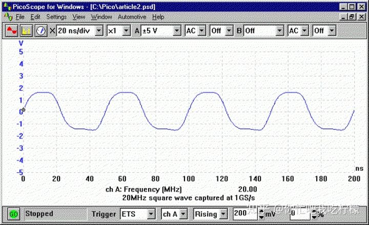

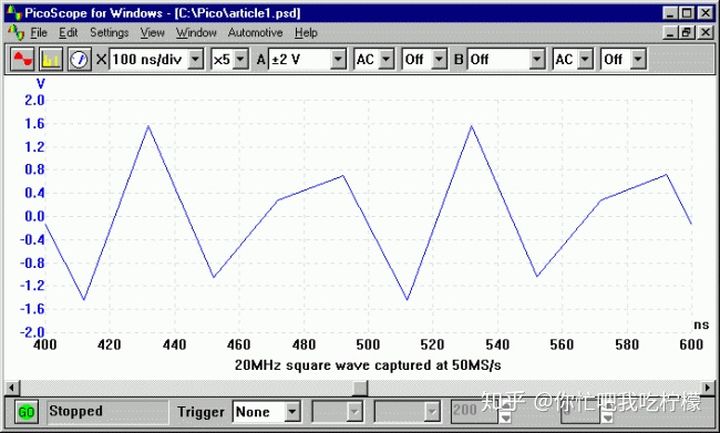

As for bandwidth. The Nyquist criterion states that the sampling rate should be at least twice the frequency you want to measure. But even at twice the rate, it is terrible at best. Consider the following pictures:
The graph captions tell the story. You need to exceed the specified bandwidth by a great amount in order to gain an accurate representation of the square wave input signal (high frequency harmonics). And greater bandwidth = greater cost.
In the end the precision, bandwidth and limited production quantities that drive up prices.
