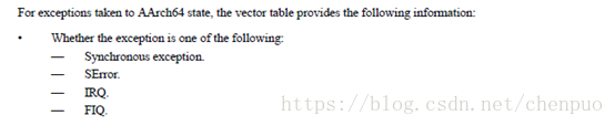

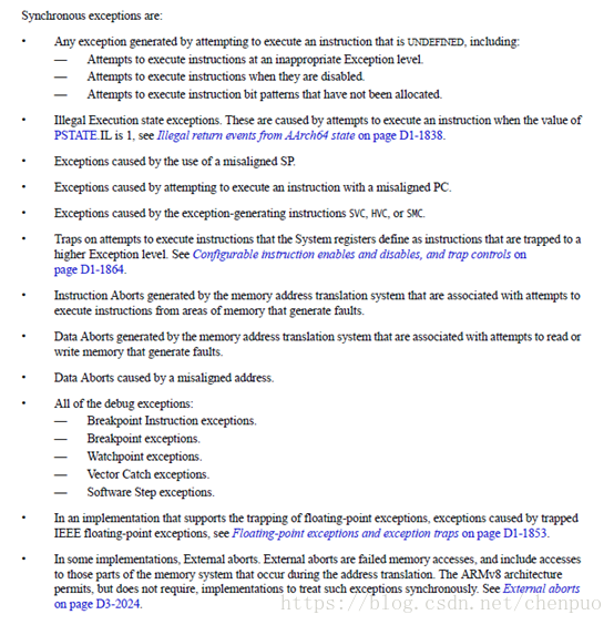

到底SError是ARM的一种什么异常,AArch64(ARM64)架构中,主要包括如下4中类型的异常:
  1. Synchronous exception(同步异常),“同步”可以理解为:发生异常的指令为导致异常的指令,即当导致异常发生的指令执行时能立即触发异常。 包括ARM架构中定义的所有Aborts异常,如:指令异常、数据异常、对齐异常等。
  2. SError,System Error,是一种异步异常,后面再仔细说明。
  3. IRQ,普通的中断,是异步异常。
  4. FIQ,高优先级的中断,是异步异常。

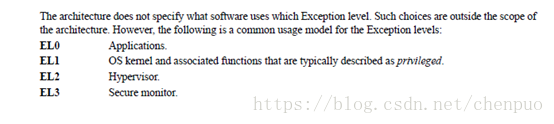

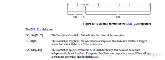

从ARM developer上查到的ESR寄存器的描述
The ESR_EL1 holds syndrome information for an exception taken to EL1.
ESR_EL1 is a 32-bit register, and is part of the Exception and fault handling registers functional group.
Figure B2-34 ESR_EL1 bit assignments
EC, [31:26]
Exception Class. Indicates the reason for the exception that this register holds information about.
IL, [25]
Instruction Length for synchronous exceptions. The possible values are:
016-bit.
132-bit.
This field is 1 for the SError interrupt, instruction aborts, misaligned PC, Stack pointer misalignment, data aborts for which the ISV bit is 0, exceptions caused by an illegal instruction set state, and exceptions using the 0x00 Exception Class.
ISS, [24:0]
Syndrome information.

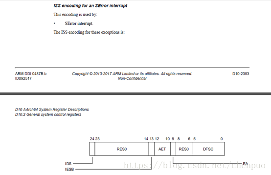

由以上信息得出前六位bit[31:26]为101111,对应具体的异常类型,查看ArmV8手册:
101111 SError interrupt即系统异常中断。
ISV, bit [24] Instruction syndrome valid. Indicates whether the rest of the syndrome information in this register is valid. 0 No valid instruction syndrome. ISS[23:0] are RES0. 1 ISS[23:0] hold a valid instruction syndrome.
本code中,该位为1,说明bit[23:0]中存放了instruction syndrome(出错指令的具体信息)
IS, bits [23:0] IMPLEMENTATION DEFINED syndrome information that can be used to provide additional information about the SError interrupt. Only valid if bit[24] of this register is 1. If bit[24] is 0, this field is RES0.
