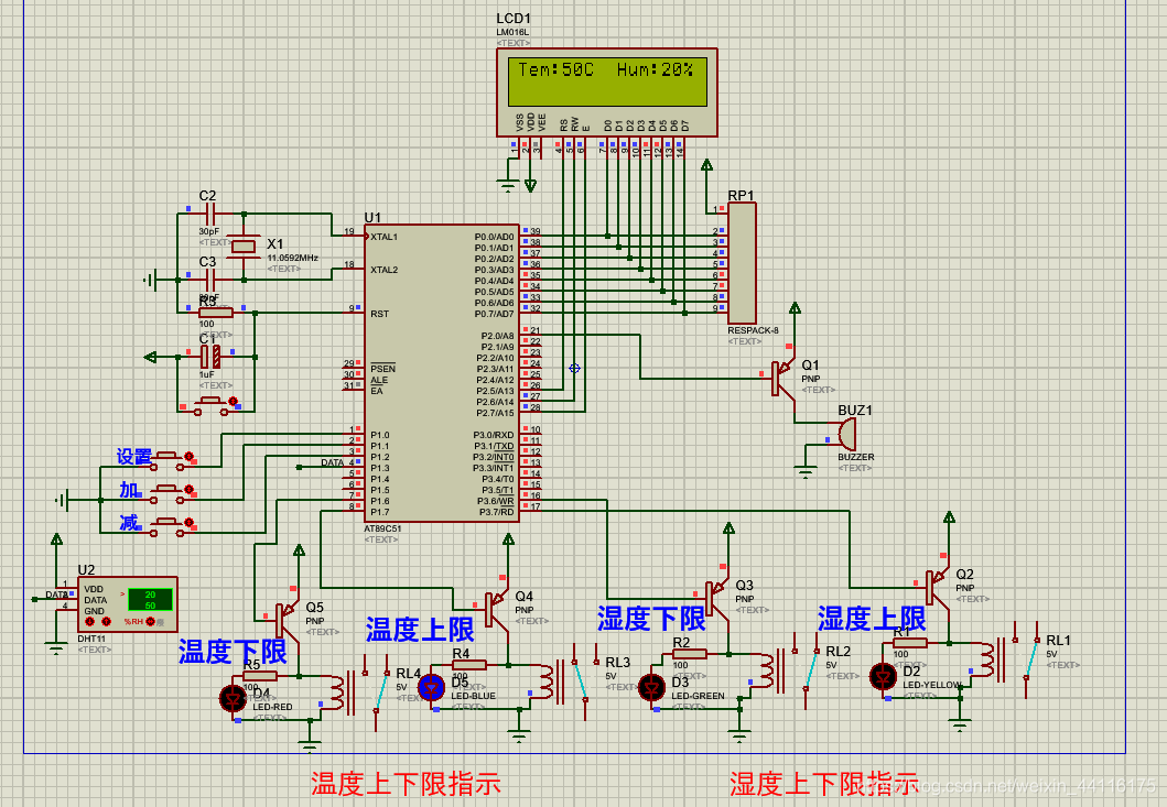

硬件设计

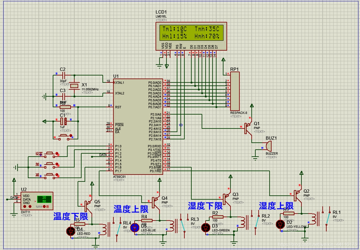

仿真图:由LCD1602作为显示器,温湿度采用DHT11,通过3个按键设置阈值,当温湿度超过上下限之后会触发分别的继电器;
在这里插入图片描述
在这里插入图片描述
程序设计
#include "common.h"
#include "lcd1602.h"
#include "dht.h"
extern unsigned char U8RH_data_H;
extern unsigned char U8T_data_H;
sbit key1 = P1^0;//设置键
sbit key2 = P1^1;//加键
sbit key3 = P1^2;//减键
sbit relay1 = P1^6;//加热继电器
sbit relay2 = P1^7;//降温继电器
sbit relay3 = P3^6;//加湿继电器
sbit relay4 = P3^7;//除湿继电器
sbit beep = P2^0;//蜂鸣器
unsigned char tl = 10,th = 35,hl = 15,hh = 70;//温湿度上下限初始值
unsigned char setn = 0;//设置标志
void display_alarm()//显示报警值
  lcd_write_char(4,0,tl/10+0x30);
lcd_write_char(5,0,tl%10+0x30);
lcd_write_char(13,0,th/10+0x30);
lcd_write_char(14,0,th%10+0x30);
lcd_write_char(4,1,hl/10+0x30);
lcd_write_char(5,1,hl%10+0x30);
lcd_write_char(13,1,hh/10+0x30);
lcd_write_char(14,1,hh%10+0x30);
void keyscan()
  if(key1 == 0)//设置键按下
delay_ms(10);
if(key1 == 0)
beep = 0;
delay_ms(100);
beep = 1;
while(key1 == 0);//等待按键松开
setn++;
if(setn > 4)//按下次数超过4次,退出设置
setn = 0;
lcd_write_com(0x0c);//关闭光标
lcd_write_str(0,0,"Tem:  C  Hum:  %");
  lcd_write_str(0,1,"                ");
if(setn == 1)//设置温度下限
lcd_write_str(0,0,"Tml:  C  Tmh:  C");
  lcd_write_str(0,1,"Hml:  %  Hmh:  %");
display_alarm();
lcd_write_com(0x80+5);
lcd_write_com(0x0f);
if(setn == 2)//温度上限
lcd_write_com(0x80+14);
if(setn == 3)//湿度下限
lcd_write_com(0x80+0x40+5);
if(setn == 4)//湿度上限
lcd_write_com(0x80+0x40+14);
if(key2 == 0)//加键按下
delay_ms(10);
if(key2 == 0)
beep = 0;
delay_ms(100);
beep = 1;
while(key2 == 0);
    if(setn == 1)
if(th - tl > 1)//上限必须大于下限,下限才能加
tl ++;
display_alarm();
if(setn == 2)
    if(th < 99)//最大到99
th++;
display_alarm();
if(setn == 3)
    if(hh - hl > 1)//上限必须大于下限,下限才能加
hl++;
display_alarm();
if(setn == 4)
    if(hh < 99)//最大到99
hh++;
display_alarm();
if(key3 == 0)//减键按下
delay_ms(10);
if(key3 == 0 )
beep = 0;
delay_ms(100);
beep = 1;
while(key3 == 0);
if(setn == 1)
if(tl > 0)//最小到0
tl --;
display_alarm();
if(setn == 2)
    if(th - tl > 1)//上限必须大于下限,上限才能减
th--;
display_alarm();
if(setn == 3)
    if(hl > 0)
hl--;
display_alarm();
if(setn == 4)
    if(hh - hl > 1)//上限必须大于下限,上限才能减
hh--;
display_alarm();
