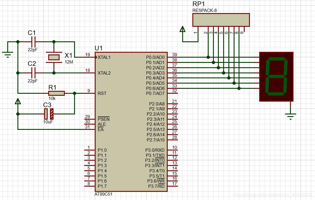

#include
#include
#define uchar unsigned char
#define uint unsigned int
uchar code DSY_CODE[]=
  0xc0,0xf9,0xa4,0xb0,0x99,0x92,0x82,0x82,0xf8,0x80,0x90,0xff
void DelayMS(uint x)
  uchar t;
while(x--)
for(t=120;t>0;t--);
void main()
  uchar i=0;
P0=0x00;
while(1)
P0=~DSY_CODE[i];
i=(i+1)%10;/*显示0-9*/
DelayMS(200);
硬件连接:
在这里插入图片描述
