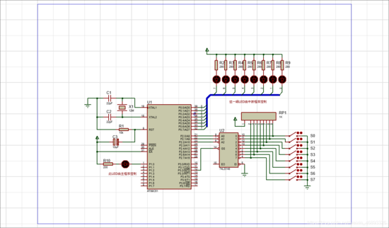

硬件连接:
代码:
#include
#include
#define uchar unsigned char
#define uint unsigned int
sbit LED = P1^0;
void EX_INT0() interrupt 0
  uchar bi = P2 & 0x07;
P0 = _cror_(0x7f,bi);
void main()
  uint i;
IE  = 0x81;
IT0 = 0;
while(1)
LED = !LED;
for(i=0;i<30000;i++);
if(INT0 == 1)
P0 = 0xff;
