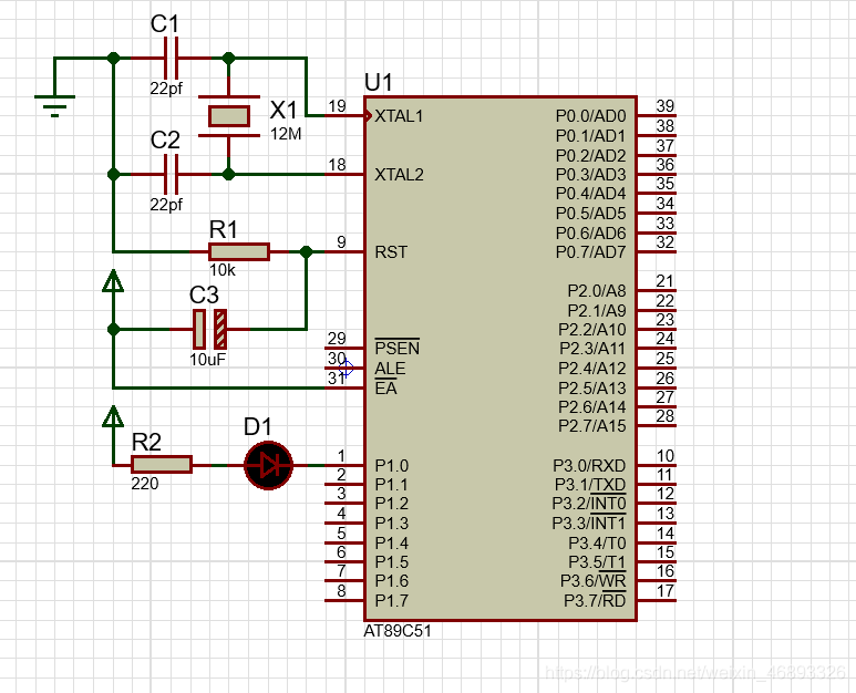

代码:
#include
#define uchar unsigned char
#define uint unsigned int
sbit LED = P1^0;
void DelayMS(uint x)
  uchar i;
while(x--)
for(i=120;i>0;i--);
void main()
  while(1)
LED = ~LED;
DelayMS(150);
硬件连接:
在这里插入图片描述
