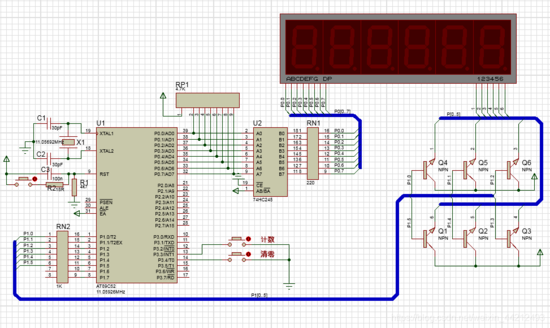

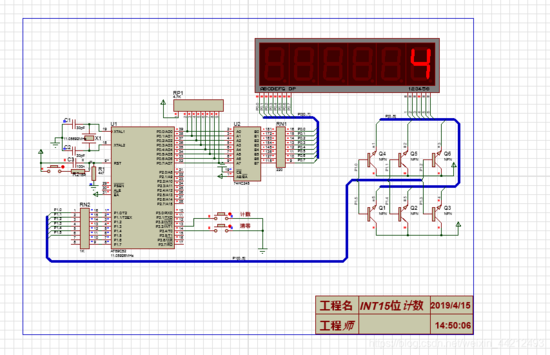

2021年12月22日 | INT1 中断五位计数器 PROTEUS 和51单片机教程
2021-12-22 来源:eefocus
在这里插入图片描述
在这里插入图片描述
程序源代码如下:
INT1中断5位计数
#include
typedef unsigned char uint8;
typedef unsigned int uint16;
sbit K2 = P3^4;
void delay(uint16 x)
uint16 i,j;
for(i = x; i > 0; i --)
for(j = 114; j > 0; j --);
code uint8 LED_CODE[] = {0xC0,0xF9,0xA4,0xB0,0x99,0x92,0x82,0xF8,0x80,0x90,0xFF};
code uint8 Scan_BITs[]= {0x20,0x10,0x08,0x04,0x02};
uint8 Buffer_Counts[]={0,0,0,0,0};
uint16 Count=0;
void Show_Counts()
uint8 i;
Buffer_Counts[4] = Count / 10000;
Buffer_Counts[3] = Count % 10000 / 1000;
Buffer_Counts[2] = Count % 1000 / 100;
Buffer_Counts[1] = Count % 100 /10;
Buffer_Counts[0] = Count % 10;
if(Buffer_Counts[4] == 0)
Buffer_Counts[4] = 10;
if(Buffer_Counts[3] == 0)
Buffer_Counts[3] = 10;
if(Buffer_Counts[2] == 0)
Buffer_Counts[2] = 10;
if(Buffer_Counts[1] == 0) Buffer_Counts[1] = 10;
for(i = 0;i < 5;i ++)
P0 = 0xFF;
  P1 = Scan_BITs[i];
P0 = LED_CODE[Buffer_Counts[i]];
delay(2);
void main()
IP = 0x04;
IT1 = 1;
IE = 0x84;
while(1)
if(K2 == 0) Count = 0;
Show_Counts();
void ISR1() interrupt 2
Count++;
