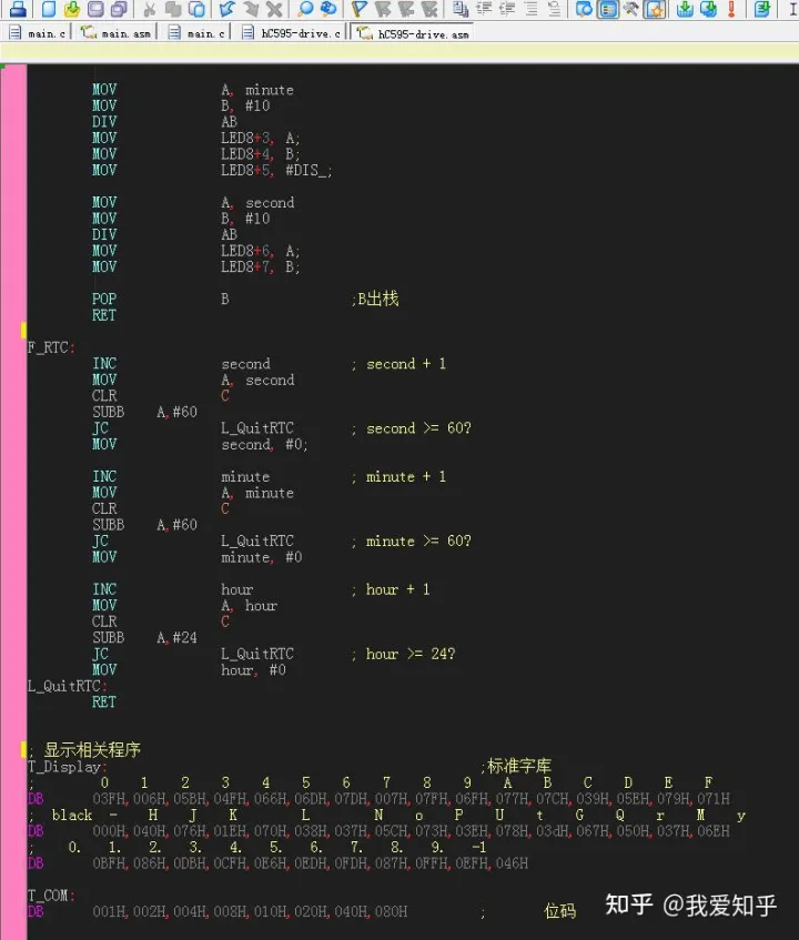

2023年01月13日 | 用汇编语言写一个数码时钟程序
2023-01-13 来源:zhihu
;功能说明
;用STC的MCU的IO方式控制74HC595驱动8位数码管。
;显示效果为: 数码时钟.
;使用Timer0的16位自动重装来产生1ms节拍,程序运行于这个节拍下, 用户修改MCU主时钟频率时,自动定时于1ms.
Fosc_KHZ EQU 22118 ;22118KHZ
STACK_POIRTER EQU 0D0H ;堆栈开始地址
Timer0_Reload EQU (65536 - Fosc_KHZ) ; Timer 0 中断频率, 1000次/秒

P_HC595_SER BIT P4.0 ; //pin 14 SER data input
P_HC595_RCLK BIT P5.4 ; //pin 12 RCLk store (latch) clock
P_HC595_SRCLK BIT P4.3 ; //pin 11 SRCLK Shift data clock

MOV hour, #12 ; 初始化时间值
MOV minute, #0
MOV second, #0
LCALL F_DisplayRTC
;主循环
L_Main_Loop:
JNB B_1ms, L_Main_Loop ;1ms未到
CLR B_1ms
INC msecond_L ;msecond + 1
MOV A, msecond_L
JNZ L_Check1000ms
INC msecond_H
L_Check1000ms:
MOV A, msecond_L ;msecond - 1000
CLR C
SUBB A, #LOW 1000
MOV A, msecond_H
SUBB A, #HIGH 1000
JC L_Main_Loop ;if(msecond < 1000), jmp
MOV msecond_L, #0 ;if(msecond >= 1000)
MOV msecond_H, #0
LCALL F_RTC
LCALL F_DisplayRTC
LJMP L_Main_Loop

F_RTC:
INC second ; second + 1
MOV A, second
CLR C
SUBB A,#60
JC L_QuitRTC ; second >= 60?
MOV second, #0;
INC minute ; minute + 1
MOV A, minute
CLR C
SUBB A,#60
JC L_QuitRTC ; minute >= 60?
MOV minute, #0
INC hour ; hour + 1
MOV A, hour
CLR C
SUBB A,#24
JC L_QuitRTC ; hour >= 24?
MOV hour, #0
L_QuitRTC:
RET
