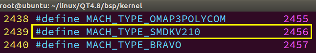

Machine查找
setup_processor() 函数用来查找CPU信息,可以结合串口打印的信息来分析。
setup_machine() 函数的传参是机器码编号,machine_arch_type符号在include/generated/mach-types.h的32039-32050行定义了。经过分析后确定这个传参值就是2456.

setup_machine() 函数的作用是通过传入的机器码编号,找到对应这个机器码的machine_desc描述符,并且返回这个描述符的指针。
其实真正干活的函数是lookup_machine_type(),找这个函数发现在head-common.S中,真正干活的函数是__lookup_machine_type

__lookup_machine_type:
    adr    r3, 4b
    ldmia    r3, {r4, r5, r6}
    sub    r3, r3, r4            @ get offset between virt&phys
    add    r5, r5, r3            @ convert virt addresses to
    add    r6, r6, r3            @ physical address space
1:    ldr    r3, [r5, #MACHINFO_TYPE]    @ get machine type
    teq    r3, r1                @ matches loader number?
    beq    2f                @ found
    add    r5, r5, #SIZEOF_MACHINE_DESC    @ next machine_desc
    cmp    r5, r6
    blo    1b
    mov    r5, #0                @ unknown machine
2:    mov    pc, lr
ENDPROC(__lookup_machine_type)
@ vmlinux.lds.S
__arch_info_begin = .;
    *(.arch.info.init)
__arch_info_end = .;
