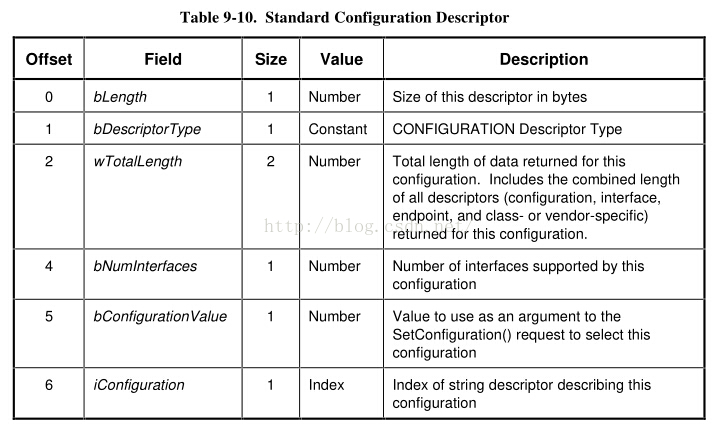

__ALIGN_BEGIN uint8_t USBD_CDC_CfgFSDesc[USB_CDC_CONFIG_DESC_SIZ] __ALIGN_END =
  /*Configuration Descriptor*/
  0x09,   /* bLength: Configuration Descriptor size */
  USB_DESC_TYPE_CONFIGURATION,      /* bDescriptorType: Configuration */
  USB_CDC_CONFIG_DESC_SIZ,                /* wTotalLength:no of returned bytes */
  0x00,
  0x02,   /* bNumInterfaces: 2 interface */
  0x01,   /* bConfigurationValue: Configuration value */
  0x00,   /* iConfiguration: Index of string descriptor describing the configuration */

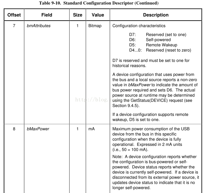

  0xC0,   /* bmAttributes: self powered */
  0x32,   /* MaxPower 0 mA */

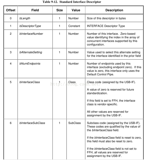

  /*Interface Descriptor */
  0x09,   /* bLength: Interface Descriptor size */
  USB_DESC_TYPE_INTERFACE,  /* bDescriptorType: Interface */
  /* Interface descriptor type */
  0x00,   /* bInterfaceNumber: Number of Interface */
  0x00,   /* bAlternateSetting: Alternate setting */
  0x01,   /* bNumEndpoints: One endpoints used */

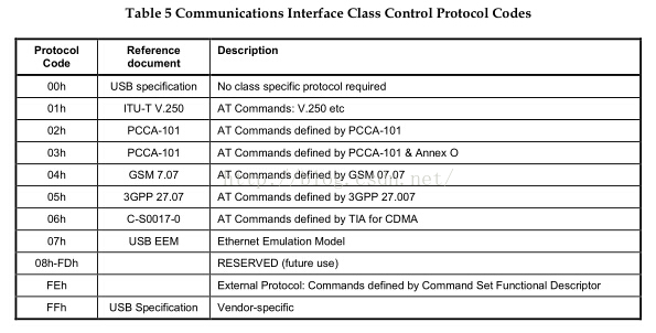

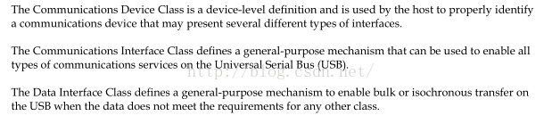

  0x02,   /* bInterfaceClass: Communication Interface Class */
  0x02,   /* bInterfaceSubClass: Abstract Control Model */
  0x01,   /* bInterfaceProtocol: Common AT commands */
  0x00,   /* iInterface: */

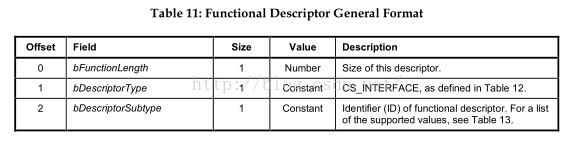

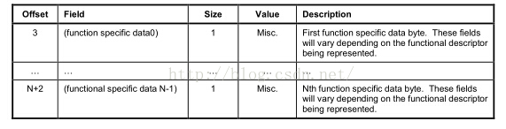

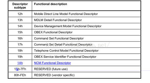

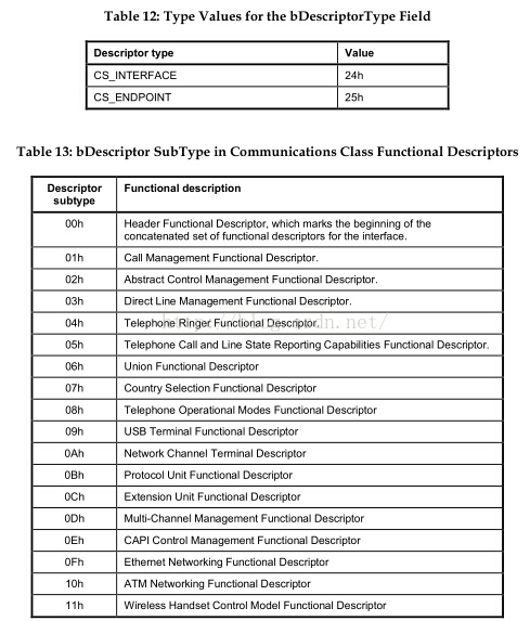

  /*Header Functional Descriptor*/
  0x05,   /* bLength: Endpoint Descriptor size */
  0x24,   /* bDescriptorType: CS_INTERFACE */
  0x00,   /* bDescriptorSubtype: Header Func Desc */
  0x10,   /* bcdCDC: spec release number */
  0x01,

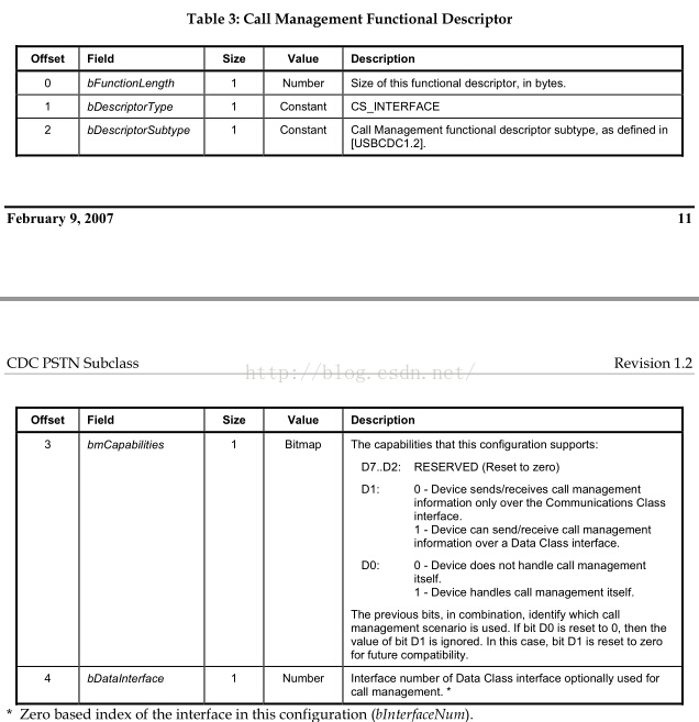

  /*Call Management Functional Descriptor*/
  0x05,   /* bFunctionLength */
  0x01,   /* bDescriptorSubtype: Call Management Func Desc */
  0x00,   /* bmCapabilities: D0+D1 */
  0x01,   /* bDataInterface: 1 */

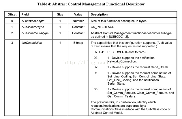

  /*ACM Functional Descriptor*/
  0x04,   /* bFunctionLength */
  0x02,   /* bDescriptorSubtype: Abstract Control Management desc */
  0x02,   /* bmCapabilities */

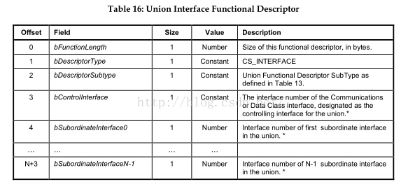

  /*Union Functional Descriptor*/
  0x06,   /* bDescriptorSubtype: Union func desc */
  0x00,   /* bMasterInterface: Communication class interface */
  0x01,   /* bSlaveInterface0: Data Class Interface */

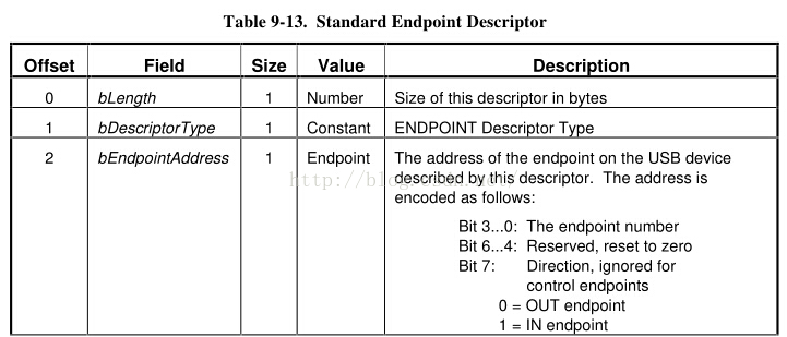

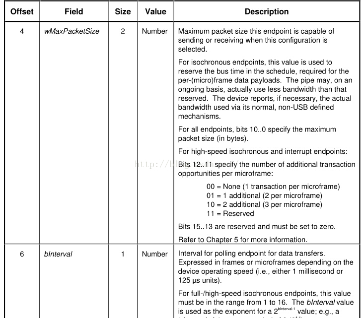

  /*Endpoint 2 Descriptor*/
  0x07,                           /* bLength: Endpoint Descriptor size */
  USB_DESC_TYPE_ENDPOINT,   /* bDescriptorType: Endpoint */
  CDC_CMD_EP,                     /* bEndpointAddress */
  0x03,                           /* bmAttributes: Interrupt */
  LOBYTE(CDC_CMD_PACKET_SIZE),     /* wMaxPacketSize: */
  HIBYTE(CDC_CMD_PACKET_SIZE),
  0x10,                           /* bInterval: */
  /*Data class interface descriptor*/
  0x09,   /* bLength: Endpoint Descriptor size */
  USB_DESC_TYPE_INTERFACE,  /* bDescriptorType: */
  0x01,   /* bInterfaceNumber: Number of Interface */
  0x02,   /* bNumEndpoints: Two endpoints used */
  0x0A,   /* bInterfaceClass: CDC */
  0x00,   /* bInterfaceSubClass: */
  0x00,   /* bInterfaceProtocol: */

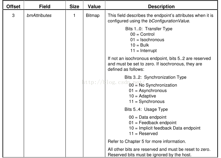

  /*Endpoint OUT Descriptor*/
  CDC_OUT_EP,                        /* bEndpointAddress */
  0x02,                              /* bmAttributes: Bulk */
  LOBYTE(CDC_DATA_FS_MAX_PACKET_SIZE),  /* wMaxPacketSize: */
  HIBYTE(CDC_DATA_FS_MAX_PACKET_SIZE),
  0x00,                              /* bInterval: ignore for Bulk transfer */
  /*Endpoint IN Descriptor*/
  CDC_IN_EP,                         /* bEndpointAddress */
  0x00                               /* bInterval: ignore for Bulk transfer */
这里只分析全速模式下的配置描述符,因为STM32F103C8T6只提供了全速USB模块,且另外三个描述符只在高速模式下才会使用,这里就不分析了,有精力的话可以看看。当获取配置描述符时其所关联的接口描述符、端点描述符都将返回,该函数很简单,但其返回的内容比较多,比较杂,还是放到后面分析吧。。。

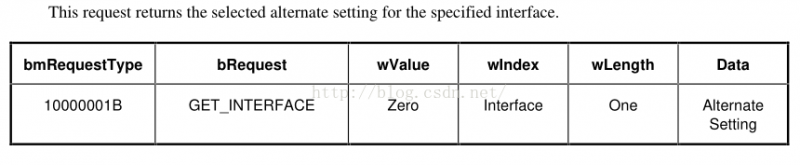

  case USB_REQ_TYPE_STANDARD:
    switch (req->bRequest)
    case USB_REQ_GET_INTERFACE :
      USBD_CtlSendData (pdev,
                        &ifalt,
                        1);
      break;

这个截图有些不全,可以参看USB2.0协议的第9章节找到该结构信息,对应本例中各个字段的值如下:
  0x00,
其中USB_CDC_CONFIG_DESC_SIZ的值为67,说明该配置描述符返回的数据总长度为67个字节,这里指示接口数目为2,但之前在usbd_conf.h文件中有一个最大接口数目的宏定义,其值是为1的,二者有些冲突,bConfigurationValue指明了该配置的值为1,当USB主机发来SetConfiguration请求设置该配置时就需要传递参数值为bConfigurationValue的值即1,后面iConfiguration这里赋的值为0,感觉有些问题,该值的含义是在字符串描述符中有关配置的字符串描述符的索引,在usbd_desc文件中有关配置的字符串描述符的索引号是0x04,二者又冲突了,bmAttributes字段表明该设备支持自供电不支持远程唤醒,最后一项,该配置下设备从USB总线上最多可以获取100mA的电流,配置描述符完毕后,其后面应该紧接着第一个接口描述符,有关接口描述符的结构如下:
接口是一组端点的集合并提供给外部功能,本例中接口描述符的各个字段值如下:
对照USB2.0协议可知该接口不支持交替设置,即接口只有一个功能,该接口使用了一个端点(除默认端点0之外),接口类为0x02,接口子类为0x02,接口协议为0x01,描述该接口的字符串描述符索引为0,这又跟usbd_desc.c文件中定义的不同,在usbd_desc.c中描述接口的字符串描述符索引号为0x05,这里有三个字段的值的含义在USB2.0协议文档找不到对应:bInterfaceClass、bInterfaceSubClass、bInterfaceProtocol。这些字段的值需要在另外一个文档CDC1.20以及PSTN1.20协议文档中找到,查看CDC1.20协议文档可知,该文档为通信设备定义了三个类:
1. 通信设备类
2. 通信接口类
3. 数据接口类
每个类各有其不同的作用,如下

在4.2章节可知通信类接口代码为0x02,Abstract Control Model子类代码为0x02,跟示例中代码一致。通信类接口的协议代码如下:
此处选择的是0x01--AT Commands,而通信设备类代码是可以用在我们的设备描述符中的bDeviceClass字段中,在本例中该字段是置0的,因此是没有使用通信设备类代码的,标准的接口描述符就分析完毕,而由于第三方类信息是作用于接口之上的,因此多出了一个功能描述符用于描述接口上的具体类信息,因此,我们可以看到示例中有很多功能描述符在接口描述符的后面,功能描述符都以一个通用的信头描述符作为起始,这样可以方便USB主机解析具体类信息,一个功能描述符的通用格式如下:
有关bDescriptorType、bDescriptorSubType的取值,如下:
bDescriptorType取值有两种:CS_INTERFACE、CSENDPOINT。bDescriptorSubType的取值很多,这些描述符主要用于通信接口类中,首先看下Header Functional Descriptor结构,如下:
在本例中信头功能描述符的代码如下:

信头功能描述符很简单,包含的内容不多,因为其只是帮助USB主机解析后面的功能描述符。功能描述符的子类有很多但不是全部都需要,下面说下联合功能描述符(Union Functional Descriptor),该功能描述符是由CDC1.20协议规范定义的,协议中只规定了信头功能描述符一定是最前面的,但没有规定剩下的功能描述符的顺序,这里先把CDC1.20协议规范定义的功能描述符分析完毕,再分析PSTN1.20协议规范定义的其他功能描述符,联合功能描述符描述了可以组成一个功能单元的一组接口之间的关系,该组接口中的一个被设计成一个主机(master)或控制(controlling)接口,可以用于接收某些具体类信息或发送一些通知,其结构如下:
本例中联合功能描述符代码如下:
可知,主接口号为0(控制接口),从接口号为1(数据接口)。在CDC1.20协议规范中有一个通信类接口描述符的示例,供我们参考,下面分析PSTN1.20协议规范描述的新的功能描述符:呼叫管理功能描述符(Call Management Functional Descriptor)、抽象控制管理功能描述符(Abstract Control Management Functional Descriptor)。首先看下呼叫管理功能描述符结构:
本例中呼叫管理功能描述符代码如下:
可知设备本身不处理呼叫管理,并指明数据类接口号为1,抽象控制管理功能描述符结构如下:
本例中抽象控制管理功能描述符代码如下:
可知设备只支持了Set_Line_Coding、Set_Control_Line_State、Get_Line_Coding请求以及Serial_State通知。至此第一个接口描述符分析完毕,跟在接口描述符后面的是其关联的端点描述符,结构如下:
内容有些长,本例中端点描述符代码如下:
可知端点是IN端点,地址为0x02,该端点是作为控制接口中的端点,但在本例实际中是没有用到的。该端点为中断端点,最大包大小为8个字节,轮询该端点的数据传输间隔是16。后面为数据接口以及跟其相关的端点描述符,数据接口中是没有功能描述符的,在此就不分析该接口了。至此,VCP例程代码分析完毕,不得不说USB通信博大精深,要想深入理解还需时日,这个只能作为入门例程帮助我们理解USB通信,同时USB器件库提供了扩展模板以便开发者开发新的设备类,想要学好USB通信,首先需要知道跟其相关联的协议规范,并知晓各个描述符的,难点就在于如何把协议规范中的理论转换成实际可操作的代码,一起努力吧!
