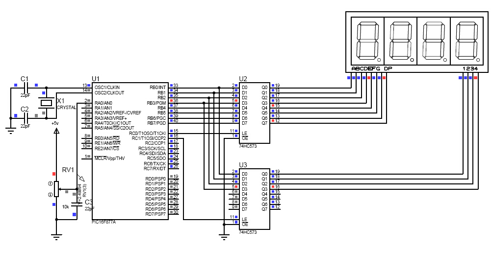

2019年10月29日 | PIC16F877_adc使用
2019-10-29 来源:51hei
#include
#define   dua  RC0
#define   wei  RC1
__CONFIG (0X3B31);
bit AD_FLAG;
const char  dua_table [] = { 0xC0,0xF9,0xA4,0xB0,0x99,0x92,0x82,0xF8,0x80,0x90 };
const char  ddua_table[] = { 0x40,0x79,0x24,0x30,0x19,0x12,0x02, 0x78,0x00,0x10 };
const char         wei_arry  [] = {0x01,0x02,0x04,0x08};  //位选编码
void delay(unsigned int x)
        unsigned int a,b;
        for(a=x;a>0;a--)
                for (b=18;b>0;b--);
void display (unsigned char dua,unsigned char wei)//显示函数
        if    (wei == 2)PORTB=ddua_table[dua];
        else  PORTB = dua_table[dua];
        dua = 1;
        dua = 0;
        PORTB=wei_arry[wei-1];
        wei = 1;
        wei = 0;
        delay(40);
        PORTB = 0;
        wei = 1;
        wei = 0;
void inital () //初始化
        TRISA=TRISA|0X01;
        TRISB=0;
        TRISC=0;
        PORTB=0;
        PORTC=0;
        INTCON=0;
        PIE1=0;
        ADCON1=0X8E;        //1000 1110
        ADCON0=0X41;        //0100 0001
void main()
    volatile long int tmp;        //一定要定义长整型,否则会溢出
        int advalue;
        char a1,a2,a3,a4;
        inital();
        ADIE=1;
        PEIE=1;
        GIE=1;
        ADGO=1;
        if(AD_FLAG==1)
                tmp=get_advalue();
                advalue = (tmp*500)>>10;
                a1 = advalue / 1000;
                a2 = advalue % 1000 / 100;
                a3 = advalue % 100  / 10;
                a4 = advalue % 10;
                display (a1,1);
                display (a2,2);
                display (a3,3);
                display (a4,4);
void interrupt get_ad() //中断函数
        if(ADIF ==1 )
                ADIF = 0;
                AD_FLAG = 1;
