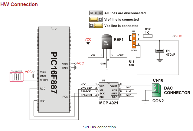

2019年10月30日 | PIC单片机的一个简单的SPI小程序
2019-10-30 来源:51hei
这里介绍一个简单的PIC单片机SPI测试小程序,希望大家能够喜欢。
// DAC module connections
sbit Chip_Select at RC0_bit;
sbit Chip_Select_Direction at TRISC0_bit;
// End DAC module connections
unsigned int value;
void InitMain() {
  TRISA0_bit = 1;                        // Set RA0 pin as input
  TRISA1_bit = 1;                        // Set RA1 pin as input
  Chip_Select = 1;                       // Deselect DAC
  Chip_Select_Direction = 0;             // Set CS# pin as Output
  SPI1_Init();                           // Initialize SPI module
// DAC increments (0..4095) --> output voltage (0..Vref)
void DAC_Output(unsigned int valueDAC) {
  char temp;
  Chip_Select = 0;                       // Select DAC chip
  // Send High Byte
  temp = (valueDAC >> 8) & 0x0F;         // Store valueDAC[11..8] to temp[3..0]
  temp |= 0x30;                          // Define DAC setting, see MCP4921 datasheet
  SPI1_Write(temp);                      // Send high byte via SPI
  // Send Low Byte
  temp = valueDAC;                       // Store valueDAC[7..0] to temp[7..0]
  SPI1_Write(temp);                      // Send low byte via SPI
  Chip_Select = 1;                       // Deselect DAC chip
void main() {
  ANSEL = 0;
  ANSELH = 0;
  InitMain();                            // Perform main initialization
  value = 2048;                          // When program starts, DAC gives
                                         //   the output in the mid-range
while (1) {                             // Endless loop
    if ((RA0_bit) && (value < 4095)) {   // If RA0 button is pressed
      value++;                           //   increment value
    else {
      if ((RA1_bit) && (value > 0)) {    // If RA1 button is pressed
        value--;                         //   decrement value
    DAC_Output(value);                   // Send value to DAC chip
    Delay_ms(1);                         // Slow down key repeat pace
