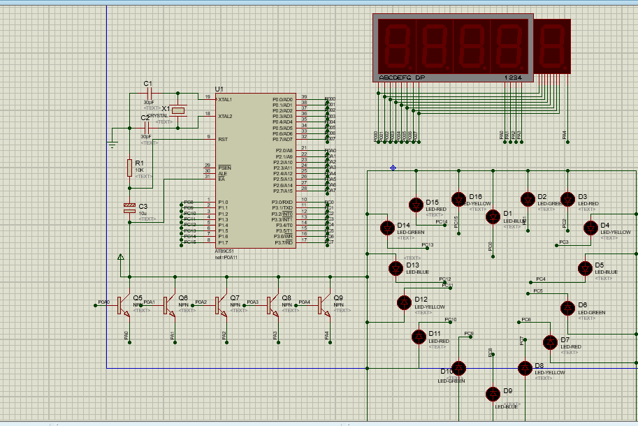

2019年12月31日 | 51单片机心形流水和数码管同步效果显示仿真与程序
2019-12-31 来源:51hei
LED流水和数码管流水效果"独立"进行,实现方法包里有代码,互相交流。
仿真原理图:
单片机源程序如下:
#include
#include
#define Number 50       //数码管数字长亮时间,t=Number*50ms=2500ms
#define Speed 6         //数码管数字显示流动速度,t=Speed*50ms=300ms
#define time100 100   //延时函数时间:t=time100=100ms
#define time1000 1000   //延时函数时间:t=time1000=1000ms
#define uchar unsigned char
#define uint unsigned int
bit flag=0;
uchar timer=0;
uchar K=0;
uchar N=0;
uchar num;
uchar num1;
uchar a;
uchar b;
uchar c;
uchar code temp[]={0xc0,0xf9,0xa4,0xb0,0x99,0x92,0x82,0xf8,0x80,0x90,0x88,0x83,0xc6,0xa1,0x86,0x8e,0xc7,0xc1,0x86};
uchar code table[]={0x01,0x02,0x04,0x08,0x10,0x20,0x40,0x80};
uchar code led[]={0x01,0x02,0x04,0x08,0x10,0x20,0x40,0x80};
