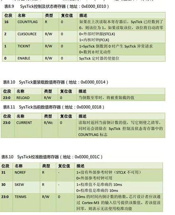

与systick相关的寄存器定义

与systick寄存器相关的寄存器及位的宏定义
/* SysTick Control / Status Register Definitions */控制/状态寄存器
#define SysTick_CTRL_COUNTFLAG_Pos 16 /*!《 SysTick CTRL: COUNTFLAG Position */
#define SysTick_CTRL_COUNTFLAG_Msk (1ul 《《 SysTick_CTRL_COUNTFLAG_Pos)
/*!《 SysTick CTRL: COUNTFLAG Mask */ 溢出标志位
#define SysTick_CTRL_CLKSOURCE_Pos 2 /*!《 SysTick CTRL: CLKSOURCE Position */
#define SysTick_CTRL_CLKSOURCE_Msk (1ul 《《 SysTick_CTRL_CLKSOURCE_Pos)
/*!《 SysTick CTRL: CLKSOURCE Mask */时钟源选择位,0=外部时钟;1=内核时钟
#define SysTick_CTRL_TICKINT_Pos 1 /*!《 SysTick CTRL: TICKINT Position */
#define SysTick_CTRL_TICKINT_Msk (1ul 《《 SysTick_CTRL_TICKINT_Pos)
/*!《 SysTick CTRL: TICKINT Mask */异常请求位
#define SysTick_CTRL_ENABLE_Pos 0 /*!《 SysTick CTRL: ENABLE Position */
#define SysTick_CTRL_ENABLE_Msk (1ul 《《 SysTick_CTRL_ENABLE_Pos)
/*!《 SysTick CTRL: ENABLE Mask */使能位
/* SysTick Reload Register Definitions */
#define SysTick_LOAD_RELOAD_Pos 0 /*!《 SysTick LOAD: RELOAD Position */
#define SysTick_LOAD_RELOAD_Msk (0xFFFFFFul 《《 SysTick_LOAD_RELOAD_Pos)
/*!《 SysTick LOAD: RELOAD Mask */
/* SysTick Current Register Definitions */
#define SysTick_VAL_CURRENT_Pos 0 /*!《 SysTick VAL: CURRENT Position */
#define SysTick_VAL_CURRENT_Msk (0xFFFFFFul 《《 SysTick_VAL_CURRENT_Pos)
/*!《 SysTick VAL: CURRENT Mask */
/* SysTick Calibration Register Definitions */
#define SysTick_CALIB_NOREF_Pos 31 /*!《 SysTick CALIB: NOREF Position */
#define SysTick_CALIB_NOREF_Msk (1ul 《《 SysTick_CALIB_NOREF_Pos)
/*!《 SysTick CALIB: NOREF Mask */
#define SysTick_CALIB_SKEW_Pos 30 /*!《 SysTick CALIB: SKEW Position */
#define SysTick_CALIB_SKEW_Msk (1ul 《《 SysTick_CALIB_SKEW_Pos)
/*!《 SysTick CALIB: SKEW Mask */
#define SysTick_CALIB_TENMS_Pos 0 /*!《 SysTick CALIB: TENMS Position */
#define SysTick_CALIB_TENMS_Msk (0xFFFFFFul 《《 SysTick_VAL_CURRENT_Pos) /*!《 SysTick CALIB: TENMS Mask */

与systick相关的寄存器的说明
SysTick寄存器说明在《Cortex-M3权威指南》(chap8.SysTick定时器章节)有说明

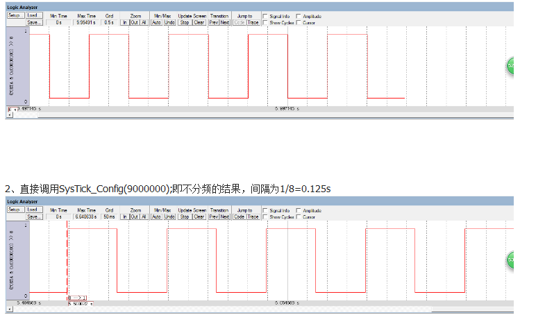

下面以一个实例来说明:
利用systick来实现以1秒的时间间隔,闪亮一个LED指示灯,指示灯接在GPIOA.8,低电平点亮。

模拟后的结果
1、8分频后结果
STM32知识:什么是SYSTICK 作用是什么
