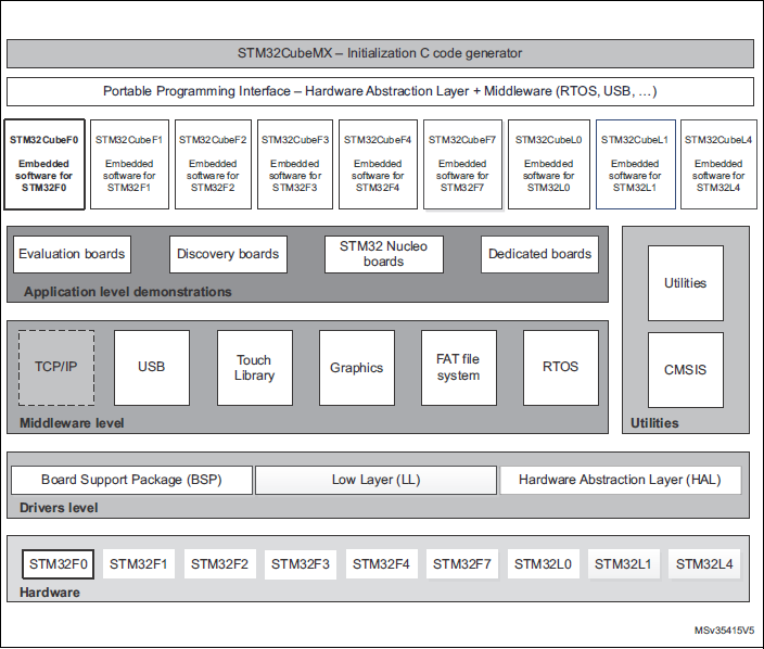

    单片机型号:STM32CubeF0
    本文介绍 STM32CubeF0。
    STM32CubeF0 gathers, in a single package, all the generic embedded software components required to develop an application on STM32F0 microcontrollers. In line with the STMCube™ initiative(首创), this set of components is highly portable, not only within STM32F0 Series but also to other STM32 Series.(大意:STM32CubeF0很不错,不仅应用于F0系列,还可用于其它STM32系列。)
    STM32CubeF0 is fully compatible with STM32CubeMX code generator that allows generating initialization code. The package includes Low Layer (LL) and hardware abstraction layer (HAL) APIs that cover the microcontroller hardware, together with an extensive(广泛的) set of examples running on STMicroelectronics boards. The HAL and LL APIs are available in open-source BSD license for user convenience.(大意:STM32CubeF0完全兼容STM32CubeMX允许产生初始化代码,开发包高阔底层和硬件映象层API覆盖了整个微处理器硬件,并且给出了大量的可在开发板上运行的样例程序,并且开源。)
    STM32CubeF0 package also contains a set of middleware components with the corresponding examples. They come in free user-friendly license terms: (大意:STM32CubeF0开发包包含一系列还有样例程序的中间件,遵循自由协议。)
    • Full USB Device stack supporting many classes: Audio, HID, MSC, CDC and DFU(USB)
    • STemWin, a professional graphical stack solution available in binary format and based on STMicroelectronics partner solution SEGGER emWin(图形用户界面)
    • CMSIS-RTOS implementation with FreeRTOS open source solution(实时操作系统)
    • FAT File system based on open source FatFS solution(文件系统)
    • STMTouch touch sensing library solution.(触摸屏)
    Several applications and demonstrations implementing all these middleware componentsare also provided in the STM32CubeF0 package.(大意:STM32CubeF0开发包提供了大量的使用这些中间件的样例程序。)
    STM32CubeF0固件组件图,如下图所示:
