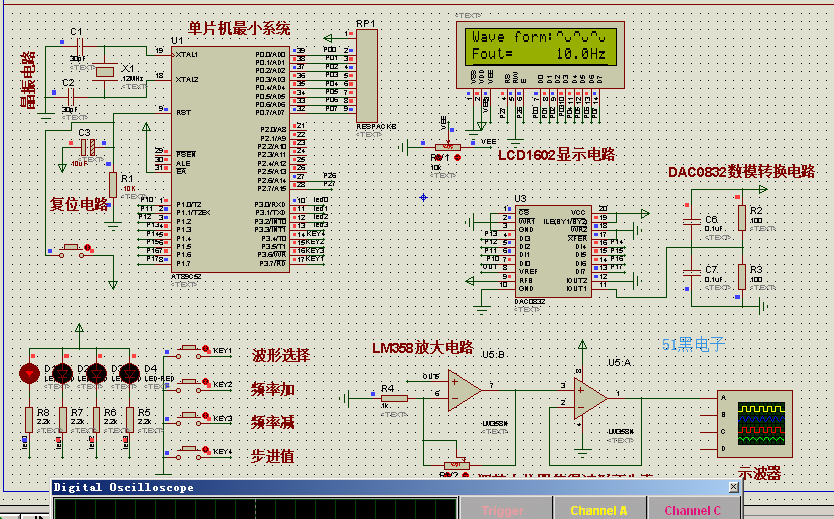

2020年09月07日 | 单片机波形发生器 (正弦、三角、方波、锯齿波)
2020-09-07 来源:51hei
单片机源程序如下:
#include                                           //包含头文件
#include
#define uchar unsigned char                           //宏定义
#define uint unsigned int
sbit s1=P3^5;                                                    //定义按键的接口
sbit s2=P3^6;
sbit s3=P3^7;
sbit s4=P3^4;
sbit led0=P3^0;                                                        //定义四个LED,分别表示不同的波形
sbit led1=P3^1;
sbit led2=P3^2;
sbit led3=P3^3;
sbit lcdrs=P2^7;                                           //液晶控制引脚,还有一个控制脚是RW,因为我们只需要向液晶里写数据系那是就好了,所以,我们直接将RW引脚接地
sbit lcden=P2^6;
char num,boxing,u;                                           //定义全局变量
int pinlv=100,bujin=1,bujin1=1;                   //频率初始值是10Hz,步进值默认是0.1,显示步进值变量
uchar code table[]="0123456789";                //定义显示的数组
uchar code table1[]="Fout=     Wave form:";        //初始化显示字符
unsigned long int m;                                   //定义长整形变量 m
int a,b,h,num1;                                                        //定义全局变量
//自定义字符
uchar code zifu[]={                   //此数组内数据为液晶上显示波形符号的自定义字符
                                                0x0e,0x11,0x11,0x00,0x00,0x00,0x00,0x00,
                                                0x00,0x00,0x00,0x00,0x11,0x11,0x0e,0x00,          //正弦波           0  1
                                                0x00,0x07,0x04,0x04,0x04,0x04,0x1c,0x00,
                                                0x00,0x1c,0x04,0x04,0x04,0x04,0x07,0x00,          //矩形波           2  3
                                                0x00,0x01,0x02,0x04,0x08,0x10,0x00,0x00,
                                                0x00,0x10,0x08,0x04,0x02,0x01,0x00,0x00,          //三角波           4  5
                                                0x00,0x01,0x03,0x05,0x09,0x11,0x00,0x00,            //锯齿波           6
uchar code sin[64]={           //此数组内的数据为,da输出对应电压值对应的数字量,0是0V,255是5V
135,145,158,167,176,188,199,209,218,226,234,240,245,249,252,254,254,253,251,247,243,237,230,222,213,204,193,182,170,158,
146,133,121,108,96,84,72,61,50,41,32,24,17,11,7,3,1,0,0,2,5,9,14,20,28,36,45,55,66,78,90,102,114,128
};                                          //正弦波取码
uchar code juxing[64]={                //一个周期是采样64个点, 所以数组内是64个数据
255,255,255,255,255,255,255,255,255,255,255,255,255,255,255,255,255,255,255,255,255,255,255,255,255,255,
255,255,255,255,255,255,0,0,0,0,0,0,0,0,0,0,0,0,0,0,0,0,0,0,0,0,0,0,0,0,0,0,0,0,0,0,0,0
};                                          //矩形波取码
uchar code sanjiao[64]={
0,8,16,24,32,40,48,56,64,72,80,88,96,104,112,120,128,136,144,152,160,168,176,184,192,200,208,216,224,232,240,248,
248,240,232,224,216,208,200,192,184,176,168,160,152,144,136,128,120,112,104,96,88,80,72,64,56,48,40,32,24,16,8,0
};                                                //三角波取码
uchar code juchi[64]={
0,4,8,12,16,20,24,28,32,36,40,45,49,53,57,61,65,69,73,77,81,85,89,93,97,101,105,109,113,117,121,125,130,134,138,142,
146,150,154,158,162,166,170,174,178,182,186,190,194,198,202,206,210,215,219,223,227,231,235,239,243,247,251,255
};                                          //锯齿波取码
void delay(uint xms)         //延时函数
        int a,b;
        for(a=xms;a>0;a--)
                for(b=110;b>0;b--);
void write_com(uchar com)                //写命令函数
        lcdrs=0;
        P0=com;
        delay(1);
        lcden=1;
        delay(1);
        lcden=0;
void write_date(uchar date)                //写数据函数
        lcdrs=1;
        P0=date;
        delay(1);
        lcden=1;
        delay(1);
        lcden=0;
//自定义字符集
void Lcd_ram()
        uint i,j,k=0,temp=0x40;
        for(i=0;i<7;i++)
           for(j=0;j<8;j++)
            write_com(temp+j);
            write_date(zifu[k]);
            k++;
           temp=temp+8;
void init_lcd()                                        //初始化函数
        uchar i;
        lcden=0;                                        //默认开始状态为关使能端,见时序图
        Lcd_ram();
        write_com(0x0f);
        write_com(0x38);                        //显示模式设置,默认为0x38,不用变。
        write_com(0x01);                        //显示清屏,将上次的内容清除,默认为0x01.
        write_com(0x0c);                        //显示功能设置0x0f为开显示,显示光标,光标闪烁;0x0c为开显示,不显光标,光标不闪
        write_com(0x06);                        //设置光标状态默认0x06,为读一个字符光标加1.
        write_com(0x80);                        //设置初始化数据指针,是在读指令的操作里进行的
        for(i=10;i<20;i++)                           //显示初始化
                write_date(table1[i]);                   //显示第一行字符
        write_com(0x80+0x40);                           //选择第二行
        for(i=0;i<9;i++)
                write_date(table1[i]);                   //显示第二行字符
        write_com(0x80+10);                                   //选择第一行第十个位置
