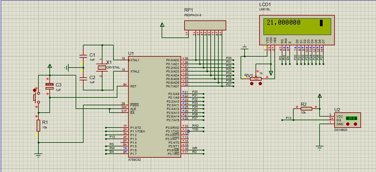

2020年12月19日 | 51单片机基于DS18B20的温度检测并显示在lcd1602上
2020-12-19 来源:51hei
单片机源程序如下:
#include
#include
sbit DQ =P1^3;
sbit RS = P1^5;
sbit RW = P1^6;
sbit EN = P1^7;
void delay(unsigned int i);
void init_DS18B20(void);
unsigned char read_DS18B20(void);
void write_DS18B20(unsigned char dat);
double read_temperature(void);
void init_lcd(void);
void lcd_write_dat(unsigned char dat);
void lcd_write_cmd(unsigned char cmd);
void main(void)
        double temp;
        unsigned char i;
        char str[16];
          init_lcd();
          init_DS18B20();
          while(1)
                        temp = read_temperature();
                        if(temp)
                                sprintf(str,"%f",temp);
                                for(i=0;i<15;i++)
                                        lcd_write_dat(str[i]);
                                delay(20000);
                                init_lcd();
     while(i--);
bit flag=1;
while(flag==1)
  DQ = 1;
  DQ = 0;
  delay(70);
  DQ = 1;
  delay(10);
  flag=DQ;
  delay(20);
unsigned char i = 0, dat = 0;
for (i=0; i<8; i++)
  DQ = 0;
  dat>>=1;
  DQ = 1;
  if(DQ)
   dat|=0x80;
  delay(4);
return dat;
unsigned char i=0;
for (i=0; i<8; i++)
  DQ = 0;
  DQ = dat&0x01;
  delay(3);
  DQ = 1;
  dat>>=1;
delay(5);
unsigned int temp=0;
double d;
init_DS18B20();
write_DS18B20(0xCC);
write_DS18B20(0x44);
init_DS18B20();
write_DS18B0(0xBE);
temp=read_DS18B20();
temp=temp+read_DS18B20()*0x100;
if(temp<0xf000)
  d=temp*0.0625;
else
  temp=~temp+1;
  d=-(temp*0.0625);
return  d;
void init_lcd(void)
        lcd_write_cmd(0x38);
        lcd_write_cmd(0x0f);
        lcd_write_cmd(0x06);
        lcd_write_cmd(0x01);
        delay(100);
        P2 = dat;
        RS = 1;
        RW = 0;
        EN = 1;
        delay(100);
        EN = 0;
        delay(5000);
        P2 = cmd;
        RS = 0;
        RW = 0;
        EN = 1;
        delay(100);
        EN = 0;
        delay(5000);
