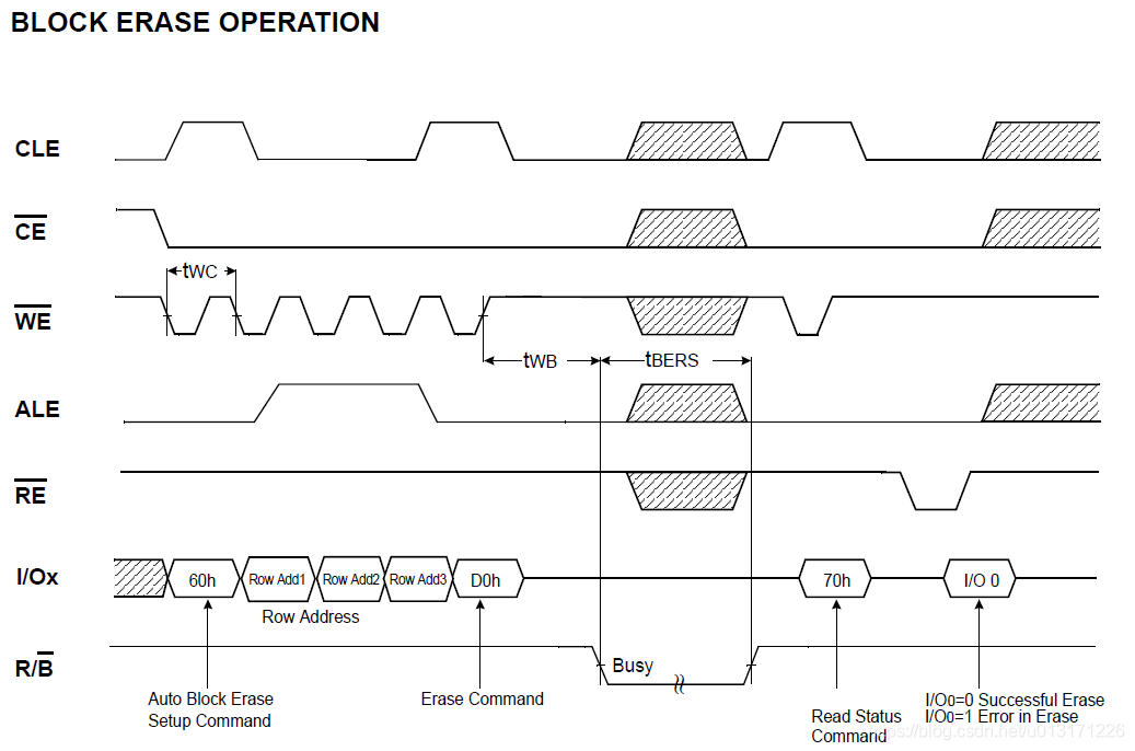

1.擦除
NandFlash是以块为单位进行擦除的,一个块是128K,从上面的时序图我们可以看到,首先我们要发出60命令,然后发出三个行地址,然后发送D0H,然后等待擦除结束。
int nand_erase(unsigned int addr, unsigned int len)
int page = addr / 2048;
if (addr & (0x1FFFF))
printf("nand_erase err, addr is not block alignnr");
return -1;
if (len & (0x1FFFF))
printf("nand_erase err, len is not block alignnr");
return -1;
nand_select();
while (1)
page = addr / 2048;
nand_cmd(0x60);
/* row/page addr */
nand_addr_byte(page & 0xff);
nand_addr_byte((page>>8) & 0xff);
nand_addr_byte((page>>16) & 0xff);
nand_cmd(0xD0);
wait_ready();
len -= (128*1024);
if (len == 0)
break;
addr += (128*1024);
nand_deselect();
return 0;

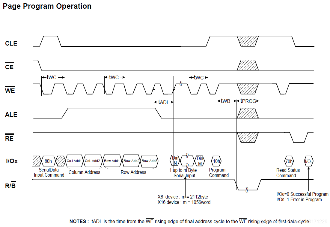

2.烧写
从上面的时序图可以看到,要想烧写NandFlash,我们首先发出80命令,然后发出五个地址,然后开始写数据,数据写完之后发出10命令,然后开始等待烧写完成。
void nand_write(unsigned int addr, unsigned char *buf, unsigned int len)
int col  = addr & (2048 - 1);
int i = 0;
nand_select();
while (1)
nand_cmd(0x80);
/* 发出地址 */
/* col addr */
nand_addr_byte(col & 0xff);
nand_addr_byte((col>>8) & 0xff);
/* row/page addr */
/* 发出数据 */
for (; (col < 2048) && (i < len); )
nand_w_data(buf[i++]);
nand_cmd(0x10);
wait_ready();
if (i == len)
break;
else
/* 开始下一个循环page */
col = 0;
page++;
nand_deselect();
