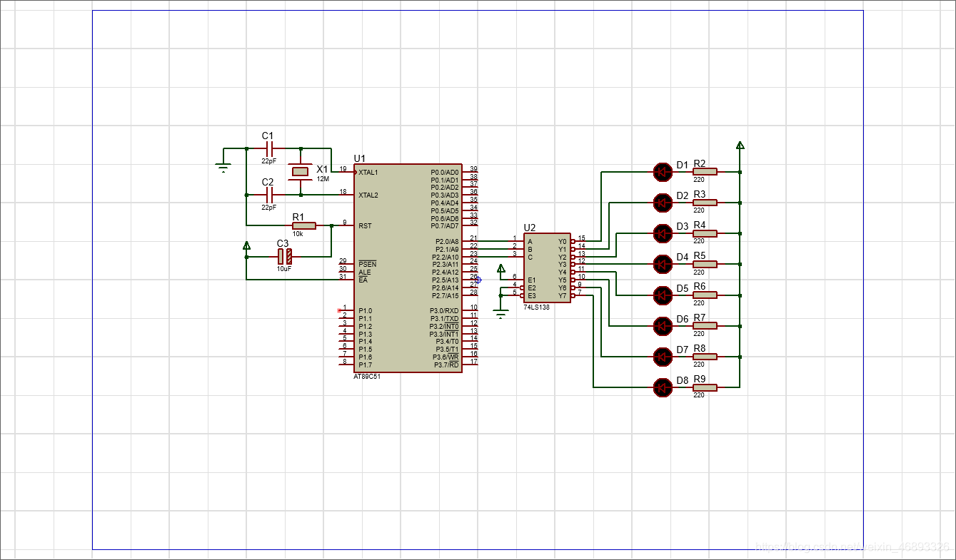

硬件连接:
程序:
#include
#define uint unsigned int
#define uchar unsigned char
void Delay(uint x)
  uchar i;
while(x--)
for(i=0;i<120;i++);
void main()
  P2 = 0x00;
while(1)
P2 = (P2+1)%8;
Delay(50);
