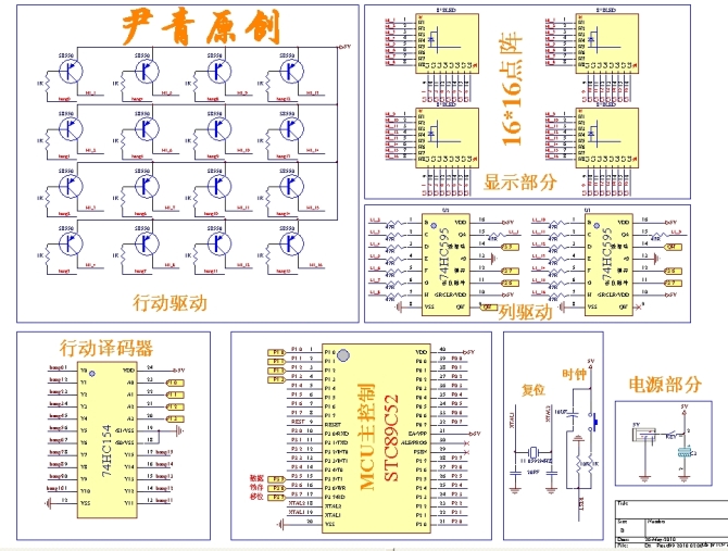

前面已经分享了,点阵汇编语言,想信大家大部分用C语言较多了,下面我就将16X16点阵上移C语言程序分享出来,希望能帮到需要的朋友!本人此程序有经过实物测试的。并非随意弄出来的。并且有配视频效果,可以点击查看的视频祥见:http://www.tudou.com/programs/view/D0SCJyO4RBQ/
下面是原理图,请大家祥细看看,不懂的帖子留言!
原理图.jpg?imageView2/2/w/550
#include
#define uchar unsigned char
#define uint unsigned int
#define LINE P0//定义行线IO口,即74HC154控制端
#define shudu 20//字移动的速度
sbit DATA=P1^4;//74HC595数据端
sbit CLK=P1^5;//74HC595移位脉冲端
sbit CLKR=P1^6;//74HC595数据锁存端
uchar move;//移动几位变量
uchar line;//行变量
uchar word;//字节变量
uchar ji;//字节变量
uchar code table[]={
0x00,0x00,0x00,0x00,0x00,0x00,0x00,0x00,0x00,0x00,0x00,0x00,0x00,0x00,0x00,0x00,
0x00,0x00,0x00,0x10,0x3F,0xF8,0x04,0x10,0x04,0x14,0xFF,0xFE,0x04,0x10,0x04,0x10,
0x3F,0xF0,0x04,0x10,0x04,0x00,0x08,0x00,0x08,0x00,0x10,0x00,0x20,0x00,0x40,0x00,
0x01,0x00,0x01,0x08,0x7F,0xFC,0x01,0x00,0x3F,0xF8,0x01,0x00,0xFF,0xFE,0x00,0x10,
0x1F,0xF8,0x10,0x10,0x1F,0xF0,0x10,0x10,0x1F,0xF0,0x10,0x10,0x10,0x50,0x10,0x20,
0x01,0x10,0xFF,0x90,0x14,0x50,0x14,0x7C,0x7F,0x50,0x55,0x90,0x55,0x10,0x57,0xFE,
0x61,0x04,0x41,0x7E,0x41,0x44,0x7F,0x44,0x41,0x44,0x41,0x44,0x7F,0x7C,0x41,0x44,
0x00,0x78,0x3F,0x80,0x11,0x10,0x09,0x20,0x7F,0xFE,0x42,0x02,0x82,0x04,0x7F,0xF8,
0x04,0x00,0x07,0xF0,0x0A,0x20,0x09,0x40,0x10,0x80,0x11,0x60,0x22,0x1C,0x0C,0x08,
0x04,0x40,0x04,0x44,0xFF,0xFE,0x04,0x40,0x08,0x7C,0x09,0x44,0x7F,0xC4,0x08,0x7C,
0x0A,0x44,0x3F,0x44,0x22,0x7C,0x22,0x44,0x22,0x44,0x3E,0x44,0x22,0x94,0x01,0x08,
0x08,0x20,0x08,0x24,0xFF,0xFE,0x08,0x20,0x01,0x08,0x3F,0xFC,0x20,0x08,0x20,0x08,
0x3F,0xF8,0x20,0x08,0x20,0x00,0x20,0x00,0x20,0x00,0x40,0x00,0x40,0x00,0x80,0x00,
0x08,0x10,0x08,0x10,0x08,0x10,0x10,0x20,0x10,0x20,0x22,0x44,0x7E,0xFC,0x04,0x08,
0x08,0x10,0x10,0x20,0x20,0x40,0x7E,0xFC,0x00,0x00,0x00,0x04,0xFF,0xFE,0x00,0x00,
void delay(uchar z)
uchar x,y;
for(x=8;x>0;x--)
for(y=z;y>0;y--);
void song(uchar z)//带参数函数
uchar num,hang;//定义变量
hang=z;//将形参给变量
for(num=0;num<8;num++)//移动8次将数据发送完毕
  if(hang&0x01==1)//将高7位屏蔽掉,保留最低位判断
  DATA=1;//为1就将74HC595数据端置1
  else
  DATA=0;//否则给0
  CLK=0;//上升沿送走数据
  CLK=1;//高电平形成上升沿
  hang>>=1;//将数移走一位
void shang()
for(move=10;move>0;move--)
  ji=word;
  for(line=0;line<16;line++)
   song(~table[ji*2+1]);
   song(~table[ji*2]);
   ji++;
   CLKR=1;//在74HC595处锁存起来
   CLKR=0;
   CLKR=1;
   LINE=line;
   delay(10);
word+=1;
if(word>=128)//7个字
  ji=0;
  word=0;
void main()
while(1)
  shang();
