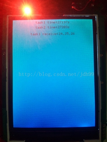

环境:
主机:WIN8
开发环境:MDK4.72
ucgui版本:3.90
ucos版本:ucos-ii
mcu: stm32f103VE
说明:
本示例中task2请求内存分区,然后往分区内写数据,再将数据通过邮箱发送给task1
效果图:
源码:
#define TASK_STK_SIZE 512
* 静态函数
static void task_start(void *pdata);
static void task1(void *pdata);
static void task2(void *pdata);
* 静态变量
* 任务堆栈空间
static OS_STK Task_Start_Stk[TASK_STK_SIZE];
static OS_STK Task1_Stk[TASK_STK_SIZE];
static OS_STK Task2_Stk[TASK_STK_SIZE];
* 信号量
OS_EVENT *Semaphore;
* 消息队列数组
void *Msg_Group[10];
char Msg_Arr[10][30];
uint8_t Index_Msg_Arr = 0;
* 内存分区
OS_MEM *Buffer_Ptr;
uint8_t Buffer[10][30];
* 函数
int main(void)
//初始化内核
OSInit();
//创建任务
OSTaskCreate(task_start,(void *)0,Task_Start_Stk + TASK_STK_SIZE - 1,10);
//启动任务
OSStart();
* 任务函数
uint8_t err = 0;
//载入世界
world_load();
//设置背景色
GUI_SetBkColor(0xb07c17);
GUI_Clear();
GUI_SetColor(GUI_BLACK);
//新建邮箱
Semaphore = OSMboxCreate((void *)0);
//创建内存分区
Buffer_Ptr = OSMemCreate(Buffer,10,30,&err);
//新建任务
OSTaskCreate(task1,(void *)0,Task1_Stk + TASK_STK_SIZE - 1,11);
OSTaskCreate(task2,(void *)0,Task2_Stk + TASK_STK_SIZE - 1,12);
while(1)
OSTimeDlyHMSM(0,0,3,0);
char str[30] = {0};
uint8_t err = 0;
uint8_t *mail;
while(1)
//请求信号量
mail = OSMboxPend(Semaphore,0,&err);
//显示
sprintf(str,"task1 receive:%d,%d,%d",mail[0],mail[1],mail[2]);
GUI_DispStringHCenterAt(str, 120, 40);
//显示
sprintf(str,"task1 time:%ds",OSTimeGet());
GUI_DispStringHCenterAt(str, 120, 5);
WM_Exec();
OSTimeDlyHMSM(0,0,1,0);
char str[30] = {0};
uint8_t err = 0;
uint8_t *ptr;
static uint8_t a = 0;
while(1)
//请求内存分区
ptr = OSMemGet(Buffer_Ptr,&err);
//赋值
ptr[0] = a++;
ptr[1] = a++;
ptr[2] = a++;
//用邮箱发送
OSMboxPost(Semaphore,ptr);
//释放内存分区
OSMemPut(Buffer_Ptr,ptr);
//显示
sprintf(str,"task2 time:%ds",OSTimeGet());
GUI_DispStringHCenterAt(str, 120, 20);
WM_Exec();
