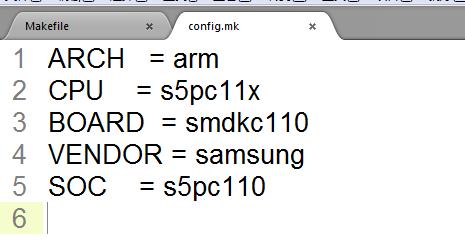

判断该目录下有无config.mk文件,有就包含改头文件,并输出 config.mk下的  ARCH(编译平台)  CPU   BOARD  VENDOR    SOC这些变量信息
1 feq ($(obj)include/config.mk,$(wildcard $(obj)include/config.mk))  wildcard函数是将展开所有符合起指定参数的文件名(指定参数为include/config.mk)
3 # load ARCH, BOARD, and CPU configuration
4 include $(obj)include/config.mk
5 export    ARCH CPU BOARD VENDOR SOC      // arm s5pc11x smdkc110 samsung s5pc110    由.mk配置文件可知
所要查找的config.mk 文件如下所示:(目录为:顶层目录下include/config.mk)
